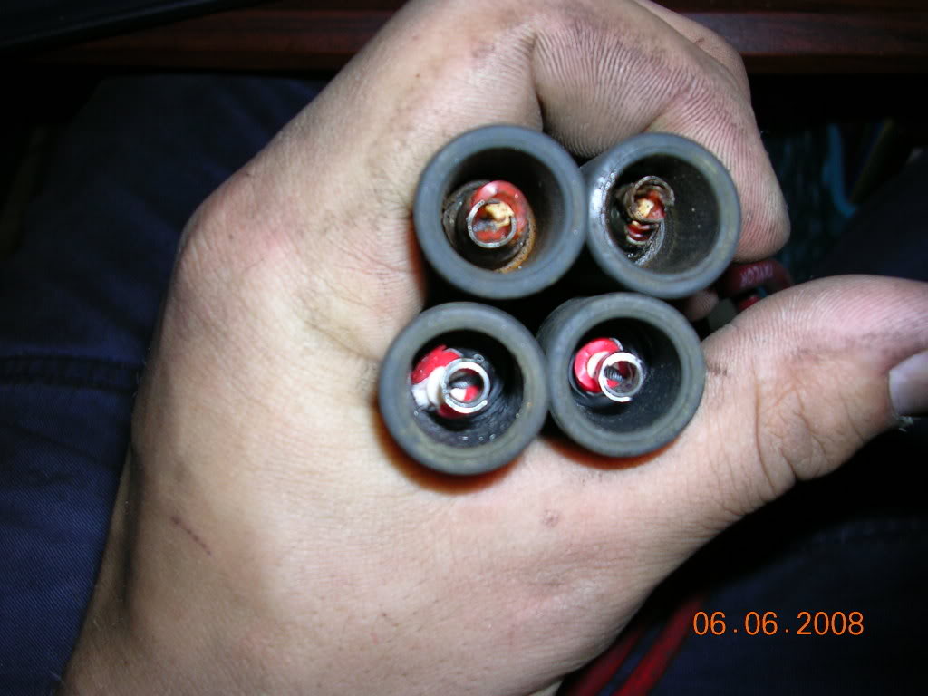

how would this effect performance?
2 of the plugs on the pass side(2,6) were in pretty bad shape. 1/2 the connector is missing.

Old Jun 6, 2008 | 11:38 PM
LOW-LIFE's Avatar
Joined: May 2008
Posts: 99
From: Fort Worthless, Texas
it could possibly cause a miss if it wasnt arcing over and getting good spark which could also cause a "pop" kinda sound on occasion

i already replaced the taylor wires with some autozone ones,
