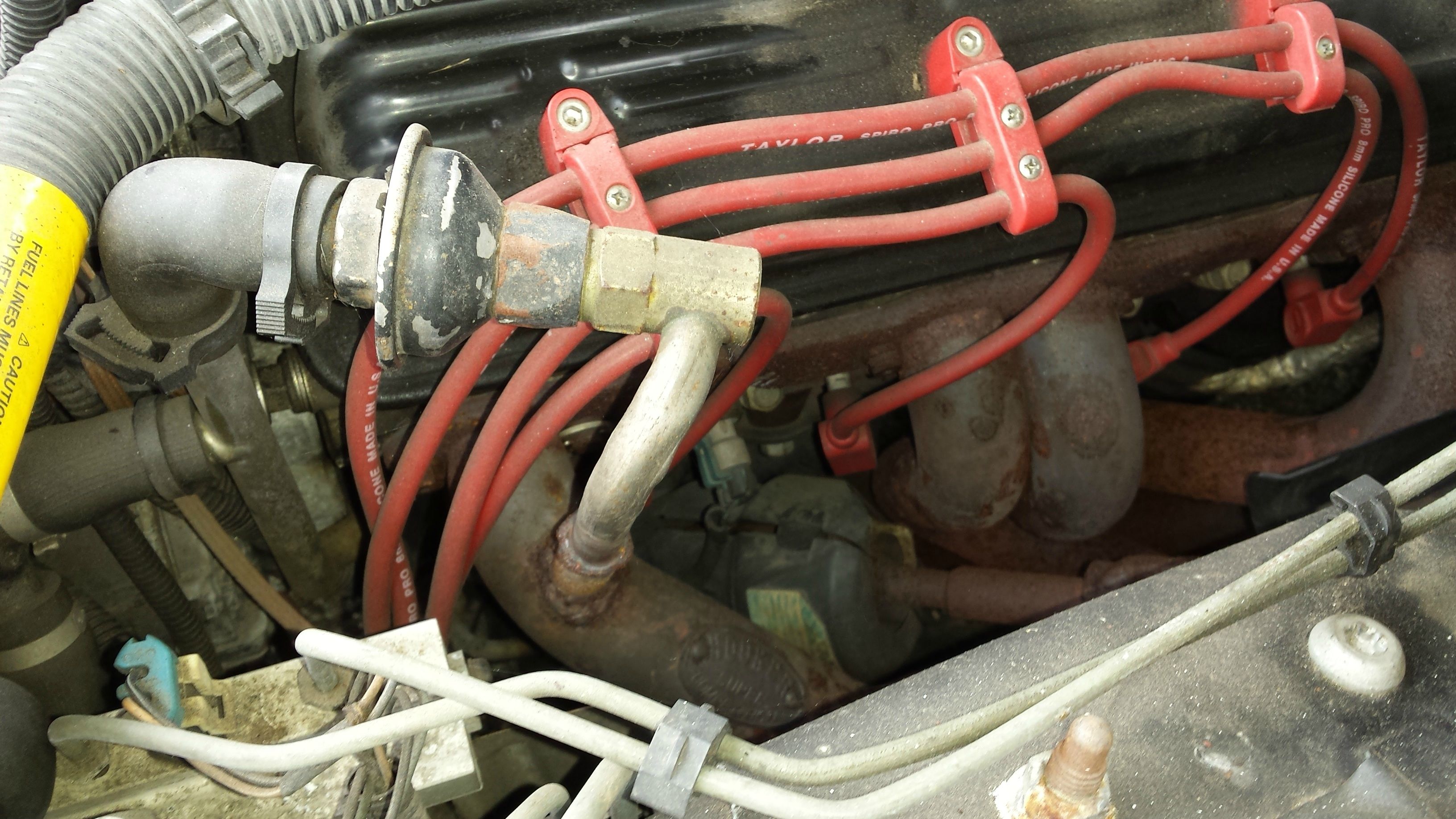

Thanks man you were exactly who I was hoping would see this. I currently have Hooker headers with all of these connections on them (attached are some pictures I just snapped). Basically I was hoping these would be an easy replacement for the rusted out pair I have in the car now. I just wasnt sure if there was an extra hole somewhere in these for some other fitting. I know I have two o2 sensor bungs and the two AIR connector tubes that look pretty similar to what is shown in his ad. I can't tell if I have the EGR connection but I'm 98% sure it does because Im 98% sure I still have EGR (this work was done before I owned it). I'm not particularly concerned about smog legal because I just registered the car classic.
Do you think this would be an easy swap out and reconnect? I assume I may have to work the AIR connections a little bit but I don't think it would be that hard. Or have some connections been moved that might make this impossible?

Yea, you know what I was thinking? These are a pretty good price. If I would have to modify the fittings, couldn't I in theory just hack them off and weld a plate over the holes and just delete AIR and EGR? It would still be 200+ cheaper than buying new coated hooker headers anyways. Do you think that would work or should I just save my money and go for new headers later?

If you cut and weld, you will destroy the coating in the area of the weld. My factory coated AS&M's had an EGT bung welded on #7 by the previous owner, and there is a small ring of rust around the bung. On the other hand, the headers are 16 years old and in decent shape.
