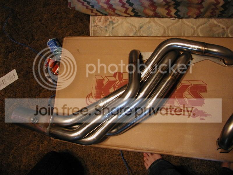

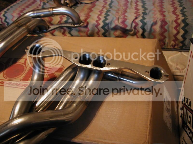

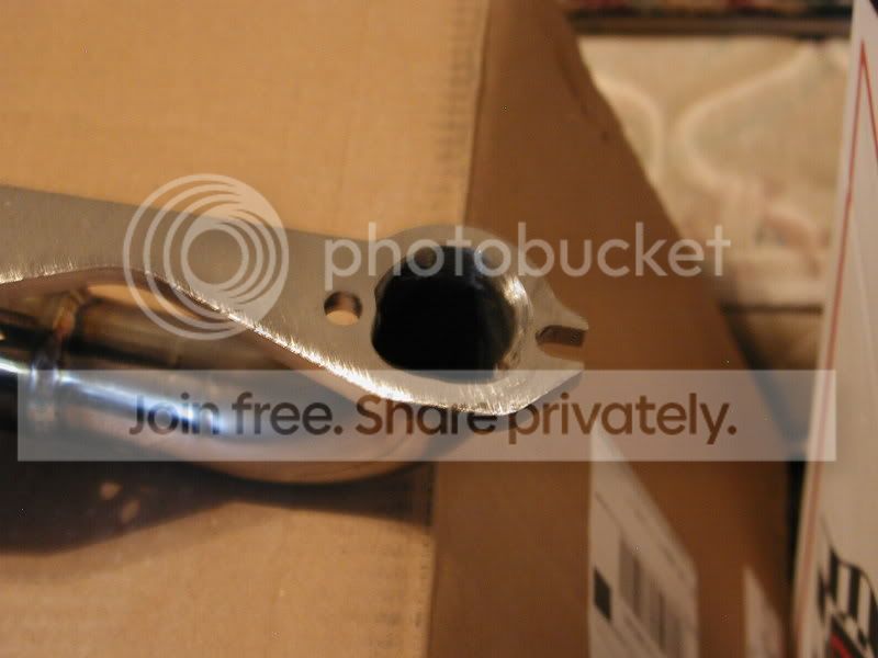

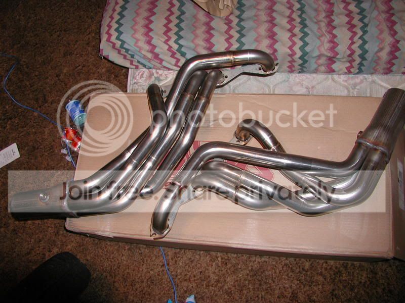

Kooks 1 7/8 Header teaser pic
I love UPS, look what what i got today
Kooks Stainless LT1 Race Headers 1 3/4" - 1 7/8" - 3.5"

Beautiful set of headers. Gotta love the Gatorade bottle in the collector.

Congrats on the new headers.. Kooks workmanship is definatly top notch !! is one of the o2 bungs facing upward? looks like it in the pic... If so what is the purpose of placing it there?

Wow, just noticed that too. looks like someone will be shipping a certain something back to cooks for adjustment, and the other one looks like the 02 bung is facing the outside...???

That is the way they placed the O2 sensors...it is fine.
Now prepare for a tight starter....pita to get plugs 5, 6 & 8 out.
Also, do yourself a favor and throw out those pos exhaust gaskets they gave you and get some Mr. Gasket 5903 gaskets.
Also, check your header bolts length wise...those headers have a thick flange and you would not want to strip out a exhaust bolt because only a few threads make it past flange.

Thanks for the tips, ya whats up with the gaskets they sent?? THey look like felt on the outside. The bolts do look shorter but the flanges look thinner than my pace flanges.
i heard that you have to run a lt4 starter with these headers, is that true?? Or will the stock starter work just a pta??
yes, uncoated, stainless steel all 900.00 worth
