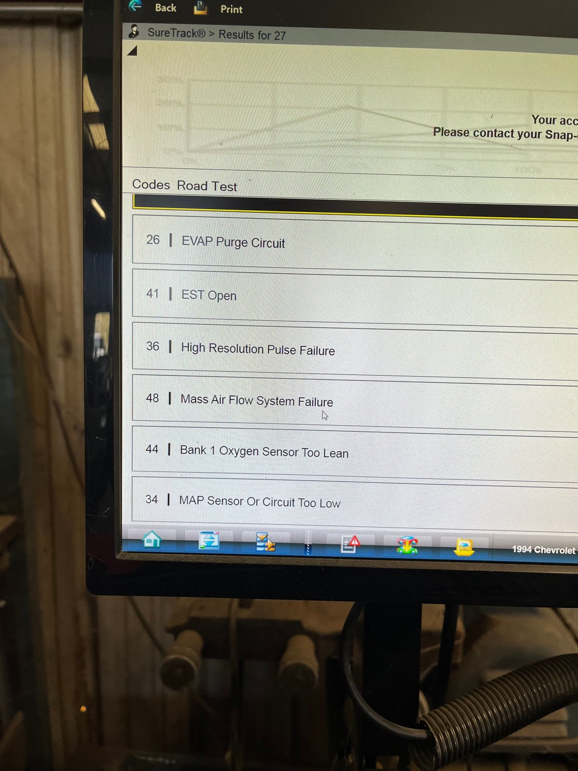

Re: I cant pass smog
Those are the codes it threw , about 6 of em .-. Idk where I should start. I suspected the o2 sensors which I was right about as well as the maf any suggestions ?
What brand scanner are you using? There are Equus and Innova scanners that give numerous false codes because they have a corrupt database for the LT1 engine.

1. Are those codes indicated as "stored" or "active"?
2. Does the SES light comes on ONLY when you put the accel pedal on the floor?
3. Does the SES light go off when you back off on the pedal?
There are contradictions in these codes setting all at once, like when you floor the accel pedal. Best thing to do would be clear the codes (pull "PCM BAT" fuse for 30 seconds) and drive the car again. Go full throttle, and if the SES light comes on, immediately check for codes. If you were running a Scan9495 data log while doing this, it would be a lot easier to decipher what is causing the problems.
DTC 26 EVAP Canister purge Solenoid Valve Circuit - Sets when the power supply to the EVAP purge solenoid is open or shorted.
DTC 34 MAP Sensor Circuit - Sets when MAP reading is irrationally low (<16 kPa). Sets when MAP = less than 16 kPA and RPM lower than 700, or when MAP = less than 16 kPa and RPM over 700, throttle angle greater than 26%.
DTC 36 Distributor (Opti) Ignition System - Sets when faulty high resolution pulse or extra low resolution pulse detected. The effect of this code is very minor, causing a slight loss of accuracy in spark timing.
DTC 41 Ignition Control Circuit (Open Circuit) - Sets when the ICM does not receive the pulses from the PCM that tell the ICM to fire the coil. Engine would not run with this code active.
DTC 44 Bank 1 O2 Sensor Circuit (Lean exhaust indicated) - This code cannot set in "Power Enrichment" mode, which is typically where the engine is operating at WOT or close to WOT (depending on RPM). Sets when the O2 sensor indicates less than 200mVolts for 50 seconds.
DTC 48 MAF Sensor Circuit - Sets when the engine is running (PCM detects reference pulses from Opti) but there is no frequency signal from the MAF sensor. Likely an open circuit.

I have no clue , I ran these at smog place before arriving I floored it so the ses light would come on , it’s very consistent turns on every time after flooring it.

yes the light only comes on after flooring it , under normal driving conditions it won’t however just to get it to the smog place which is about 35 mile round trip here and back it spent half a tank of gas. And no the code immediately clears after turning the car off and turning it back on

Can't understand your answers. Let's try again:
1. Are those codes indicated (in the scan device) as "stored" or "active"?
2. Does the SES light comes on ONLY when you put the accel pedal on the floor? Got it
Are you describing the SES light, or the existence of codes in the PCM? Codes in the PCM should not clear because the key was turned to "OFF". They should remain stored.

oh okay I understand now , I only had the codes read after the light was on however , I did not check to see if they were stored or not .
