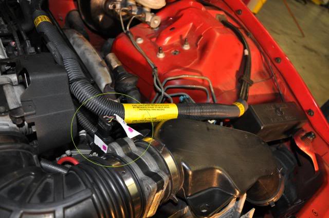

Replacing / removal and cleaning of the MAF (Mass air-flow Sensor) is very easy. It is doing small jobs like this when quoted 400 dollars that create car enthusiasts or car diy'ers.
First: loosen the worm-gear band clam on the air-box to relieve the tension.

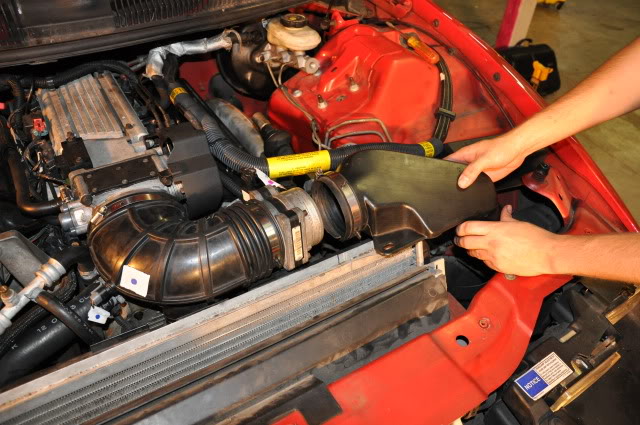

Second: remove the air-box.

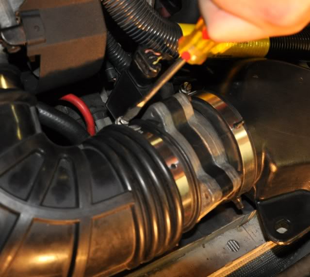

Third: loosen worm-gear clamp from the air-box side of the MAF.

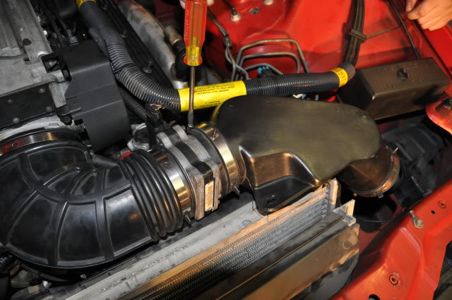

Sixth: loosen band clam on the intake manifold side of the MAF

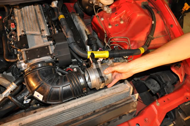

Last: remove harness connector to MAF and remove MAF.
