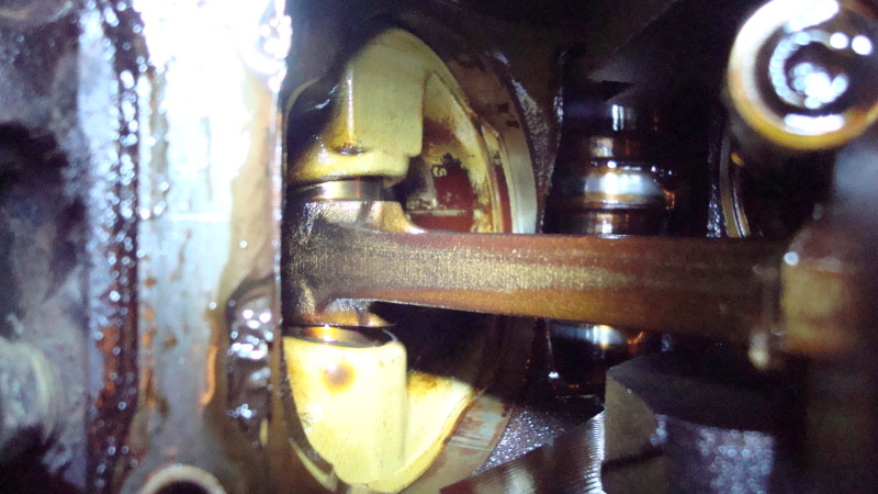

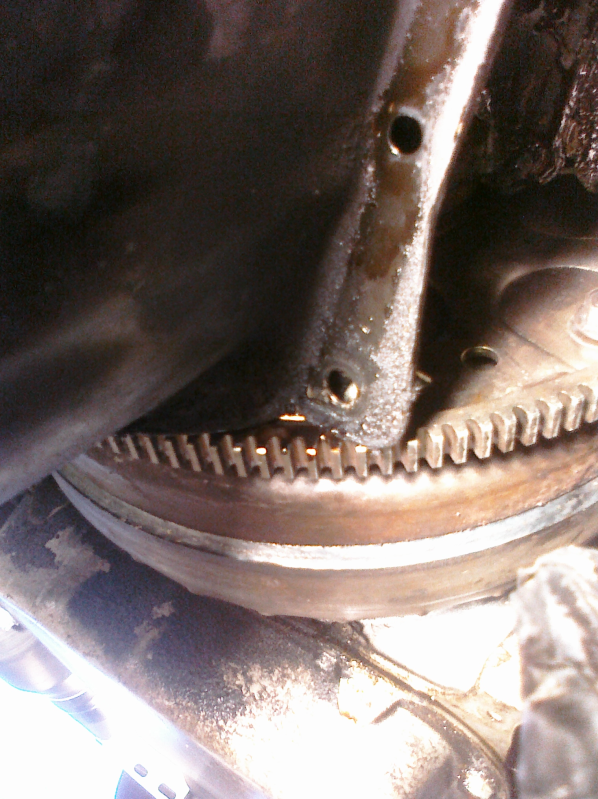

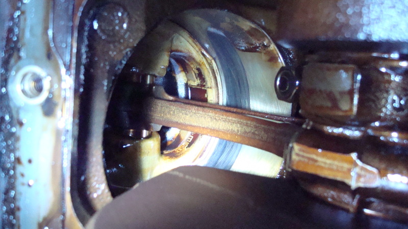

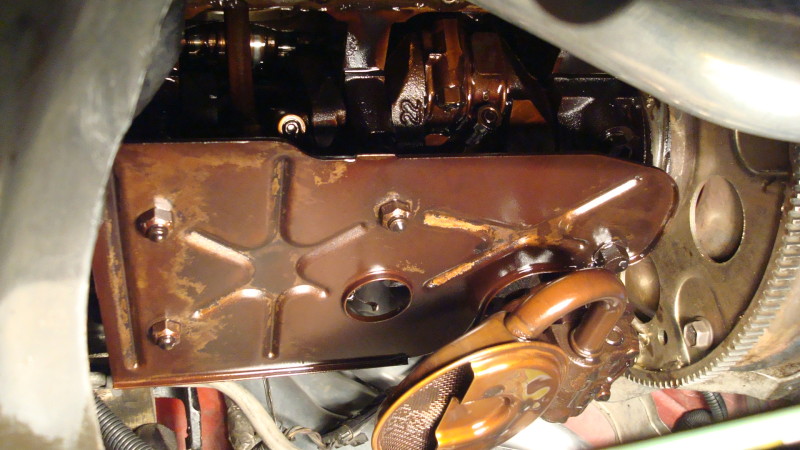

And some engine pics

Originally Posted by raroz28
I replaced my oil pan gasket back in like 2007 with it on the car. I didn't even remove the oil pan and I snapped my oil sensor off. Not sure how I did it to this day.
In the first pic I posted the oil level sensor sits between that pan/metal sheet and the oil pick up. The thing is made of plastic and even the weight of the oil pan is enough to break it. I almost broken mine trying to put it back on when my header got in the way.
I was also thinking about doing it the way people mentioned with the "sock" method, maneuvering it around the pan and dip stick tube, but there was so much old crap on there and the pan had a dent in it i needed to pound out.
