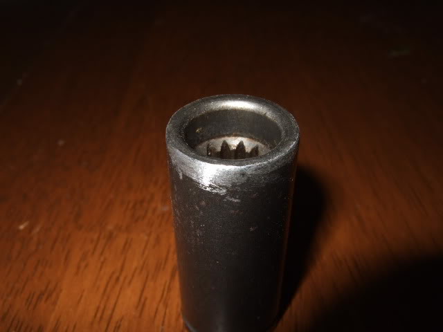

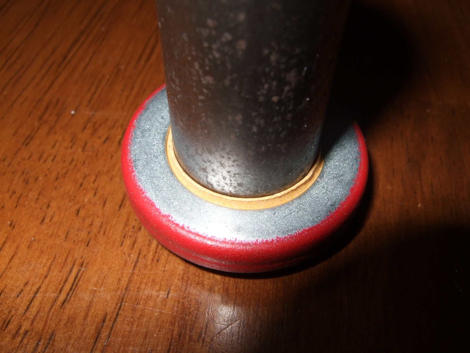

I slightly beveled the wp connector coupler to get the seal on easy. I really didn't take much off with a dremel.
Hal

Hal, thanks for those pics, that is great. Seems others have used the coupler as well (perhaps without removing any material?). Did you oil it or install it dry (I think dry is the correct way??)?
ACE1252, in that pic (which you also posted in reply to my question on this very topic in another thread; thanks for that, by the way), it looks as though the marker is slightly smaller in diameter than the shaft. It seems like that would invite the lip of the seal to catch on the shaft, which is what the tool is supposed to be preventing. I guess the marker is close enough that it works?
I'm still wondering about using oil on the seal to guide it on the tool (and onto the shaft). From what I've read, the seal should be installed dry, yet I keep seeing people using oil on the tool.
