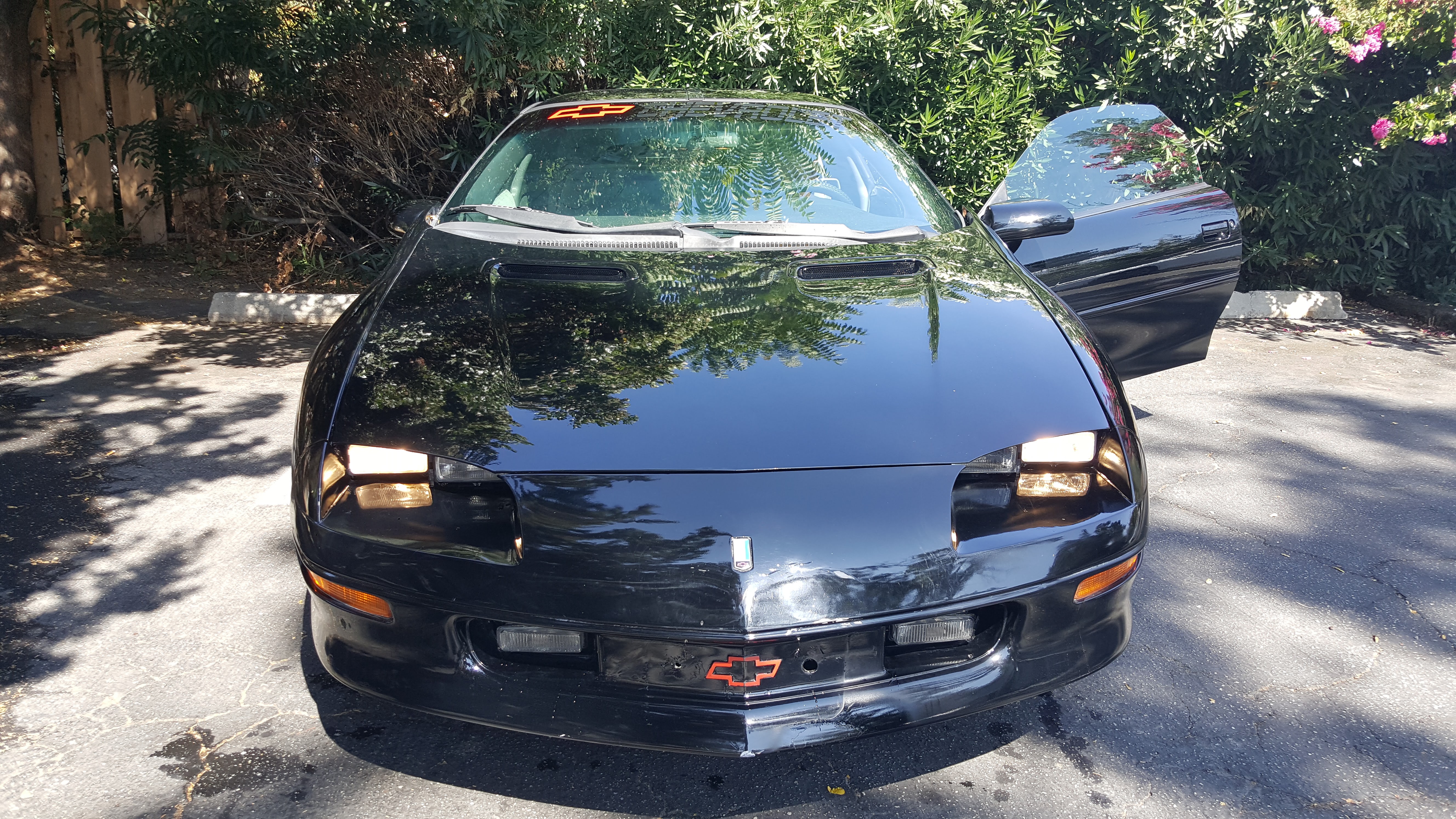

i need help chossing gears for my 1997 camaro z28 lt1 6 speed.
i was thinking of 3.73 gears? any suggestions?
also im having hard time finding the right gears that would fit my car if anyone knoes the specifications of the gears im running stock as of now.
