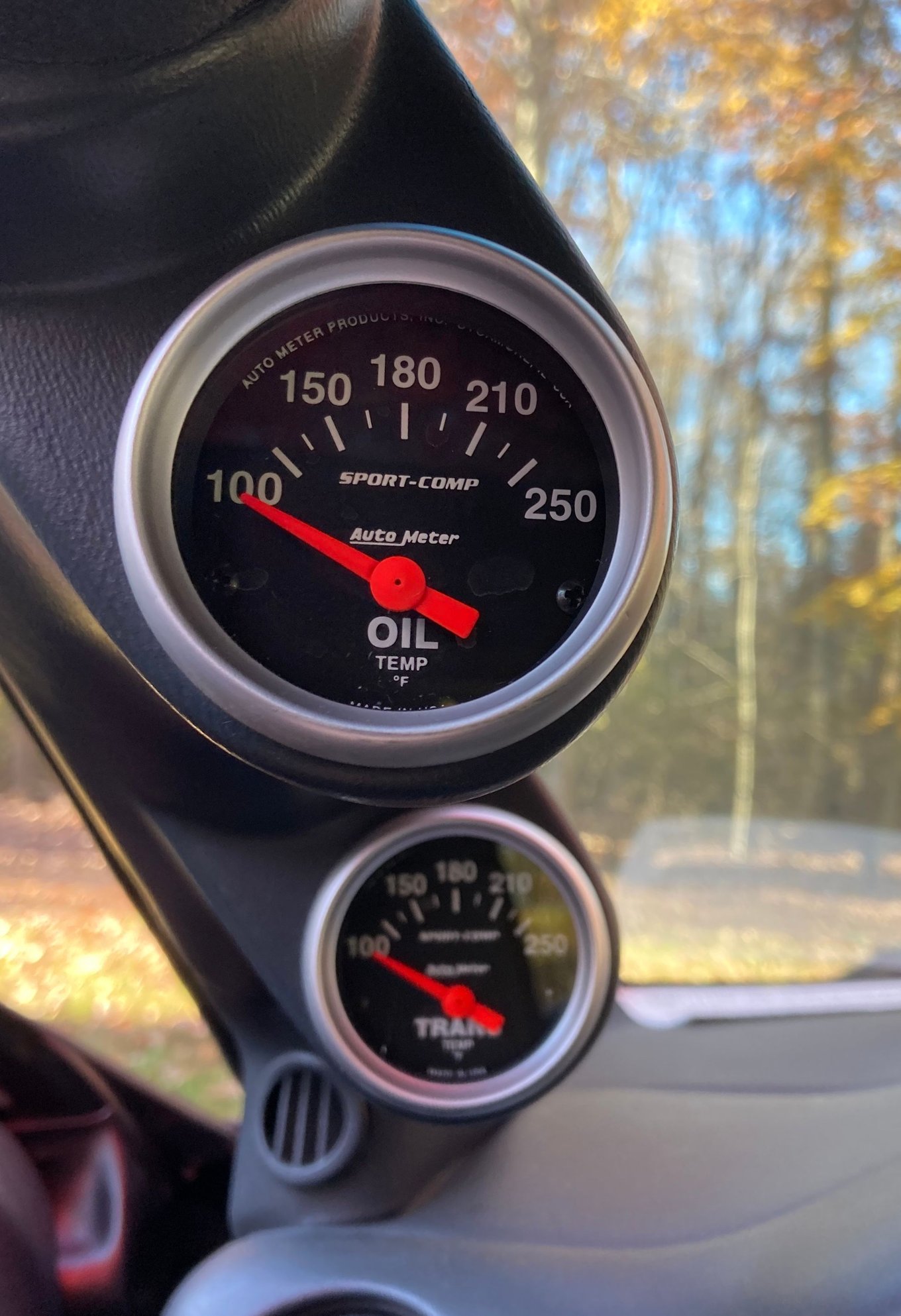

My approach to minimizing concerns about oil temperature:
