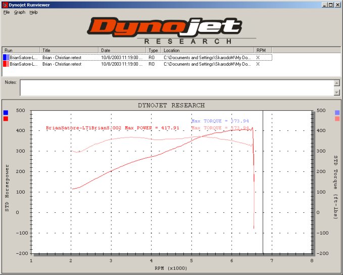

Here are his older dyno sheets:
STD
SAE
Those #'s were through his full 3" catback.
As far as the cam, I won't give specs on my custom stuff. Most people who buy heads don't run my grinds anyway, as they just buy whatever I suggest however. The 211 is a bit of an amalgam of the 230/236 XE grind, and the venerable cc306. It isnt big or anything, most guys with it are running it with stock gears in daily drivers .
