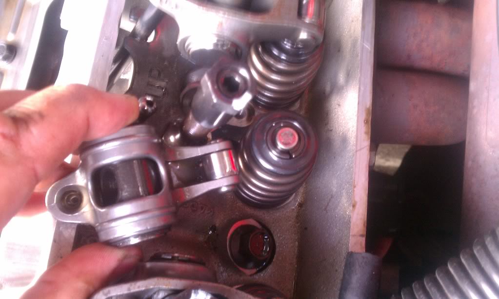

So last year I noticed some of the rockers were off center over the valve. The guide plates wore out. I replaced them but didn't notice the damage at the time. I am checking everything over to track down a tick and I think I found it. The guideplates that wore the worst messed up one two rockers and the valves they push. here are pictures. so I am hoping there is somehting I can do without getting them replaced. ekkk. Can the comp cams 1.6 full roller 7/16 stud 1.6 pro mag roller rocker tips be replaced? (that is the least of my worries, i am worried about the valves)

The old guide plates that wore down came with the heads when I bought them used, not sure what they were. I replaced them with Trick Flow 23 Degree guide plates about 1500 miles ago (beginning of last year)
http://www.summitracing.com/parts/TFS-30400623-8/
All the new guide plates I installed in 2010 look perfect still, I think the old ones were just low quality. I cant believe I missed this when I replaced the guide plates.. I guess its not the worst thing in the world if I needed to pull the heads at this point, im right there its just a few bolts and a new head gasket, I can get those two valves with the tips wore out replaced and take a look at all the others. But is there a way around it? do they make a cap or something? I have heard of guys taking a 4inch grinder to it while on the engine to make it flat. I know it cant me made perfect but im sure I can get it much better, it will throw off the geometry on that one tho. . thought? Thanks for your input

Yea I think the only PROPER/true fix is some replacement valves and rockers for those valves. But it only takes about 20 mins to get the intake manifold off to the point I am at now (plus $20 in gaskets, not to bad), and I already have damage to both rockers. I'm going to go for an experimental "ghetto" fix where I cheap out now and it ends up costing me more time and money later. lol. but I did a lot of thinking about this one and worst case scenario I will waste $20 (gaskets) and about an hour of time if I fix it this way and I end up having to pull it back apart to do it right. I will keep a very close eye (and ear) on how these rockers and valves ware with miles.
I have been Google searching for a few hours and found a few people that have used a dremel tool (or even a 4" angle grinder )to fix issues like this while the head is still on the car. I need to remove as little material as possible, keep the valve stem cool by running a cutting fluid over it (and having a towel absorb it once it falls, then change oil right after). Try to grind it as flat and smooth as I can, cleaning it up with a very high grit sand paper bit in the dremel. Not sure about maybe trying to harden or temper the stem once I am done - will have to look into that. But I will keep you all updated. I am going to reuse the rocker that has some side wear since it does not even touch the valve anymore and i ordered one replacement rocker for the one that has a chip out of the roller tip.

Well I got them almost done but my battery was getting dead. I will finish tomorrow. Here is what I have so far, before and after. I need to cleanup the dust too.

Wait, why am i even doing that. they make lash caps?.. caps for the valve stems, looks like a nice new surface for the rocker arm to run on. Right? and only $35 at my local AutoZone. Then maybe a different push rod, maybe. I will check the pattern but with so little change i cant see it being much off. Valve stem diameter is 0.3415" = ~11/32" I believe.
http://www.autozone.com/autozone/acc...ier=86012_0_0_
EDIT, yea looks like this will be the cheapest, easiest, safest solution I think:
Under $10 to order just 2 from Jegs/ebay
http://cgi.ebay.com/ebaymotors/Comp-...ehicleQ5fParts
