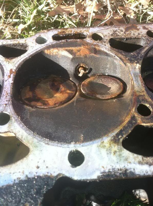

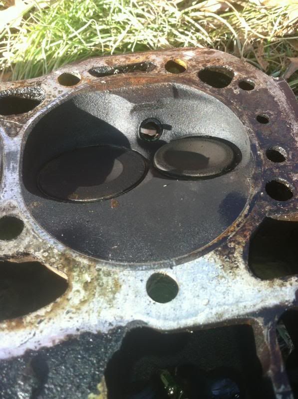

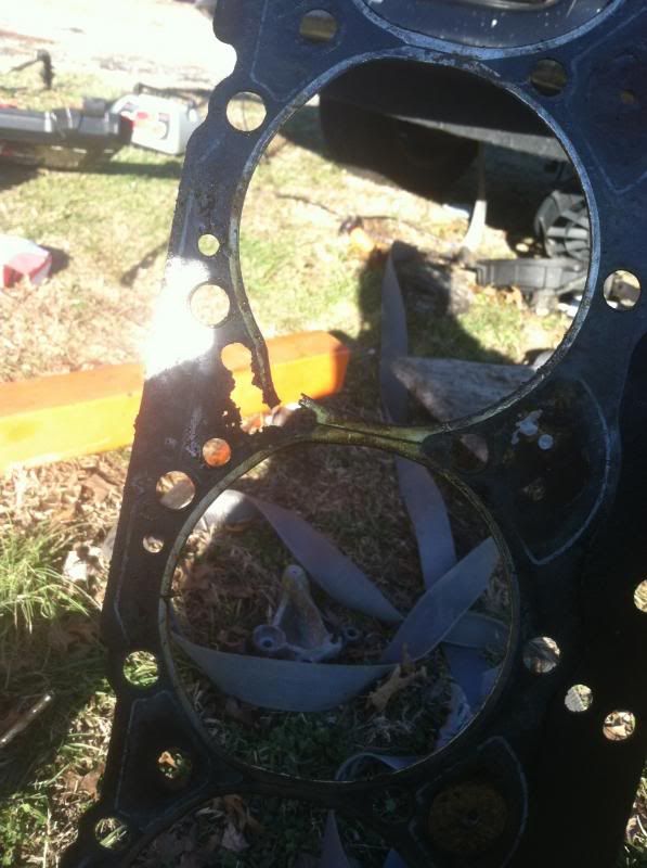

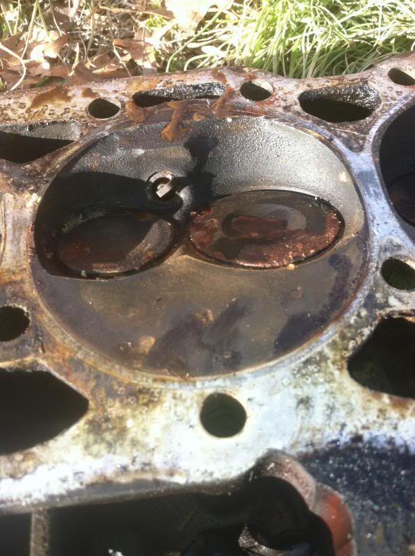

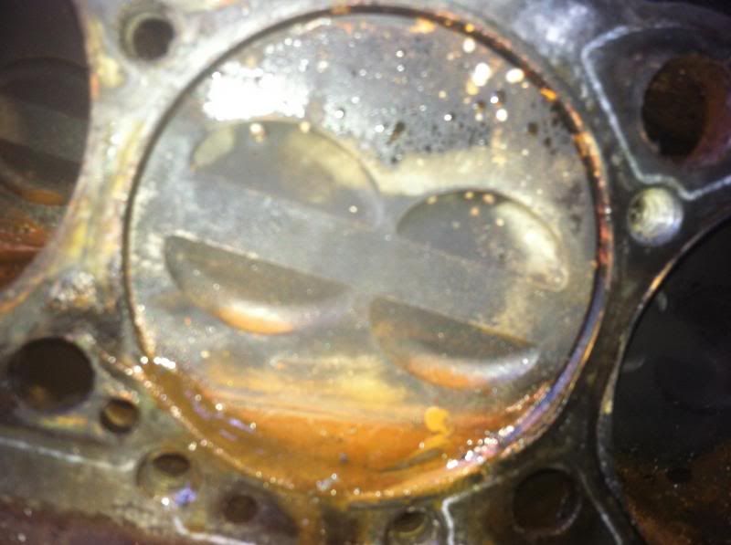

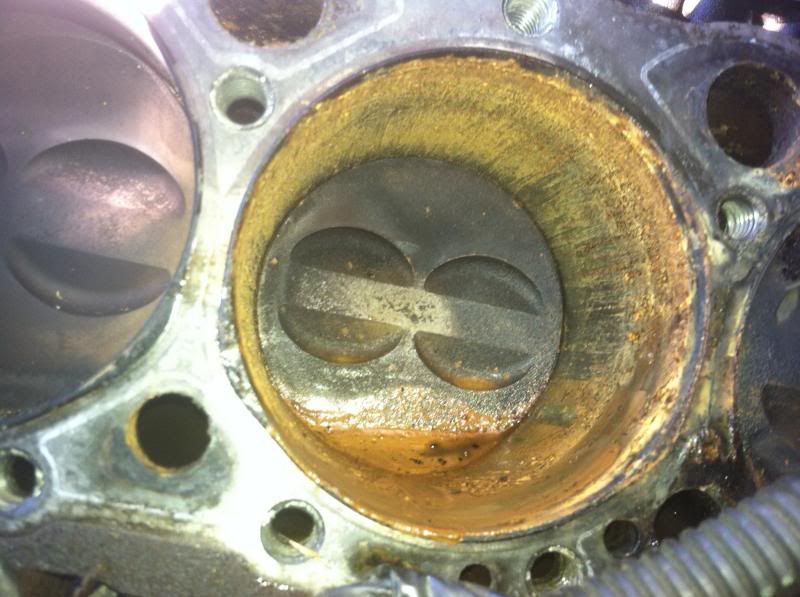

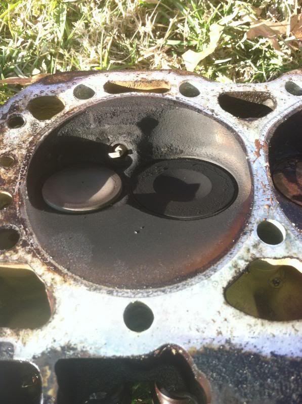

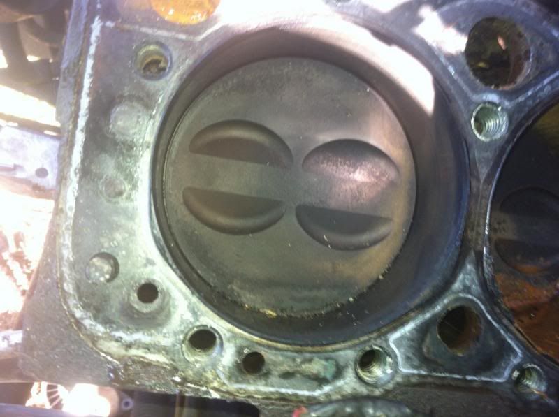

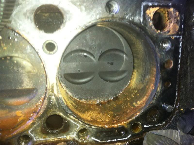

I found out more info. I managed to get the driver side head off and here is the result.
http://i114.photobucket.com/albums/n...ps542030eb.jpg
http://i114.photobucket.com/albums/n...ps7ece1741.jpg
http://i114.photobucket.com/albums/n...ps46ad3c39.jpg
http://i114.photobucket.com/albums/n...psd4624fba.jpg
http://i114.photobucket.com/albums/n...psca0dd070.jpg
http://i114.photobucket.com/albums/n...psc59a78c3.jpg
http://i114.photobucket.com/albums/n...ps0b5059a2.jpg
http://i114.photobucket.com/albums/n...psec5e5b84.jpg
http://i114.photobucket.com/albums/n...ps8724b1ce.jpg
I posted into a sloppy mechanics page on facebook and they told me that the cylinders are okay and could of been due to the fact that the intake and valve covers have been removed and the engine is still in the hood of the car. (It's either the engines under the hood or in the yard, I don't have a garage to do this work lol.) Unless this is the cause of the knock, I have yet to find any other problems. I still need to remove the passenger side head, and then look at the bearings. Something is telling me that it may be a rod or main bearing issue.

Bumping, with the information above if the passenger side head comes off with around the same, or no extra damage should I start digging into a bearing problem as a knock or would cleaning this up and getting a head gasket most likely fix this knocking sound I hear?

if you used the "proper" hub removal tool it would have easily come off. It is made by Kent Moore. There are other "ways" to remove it but cutting it off is not one of them.
Now you are pulling the motor further apart...your "knock" may be a bearing or wrist pin. you first should have done a leak down test but you are past that chance now.
You need to look at bearings which means the "bottom" of the motor needs to come apart. This is best done with motor out of the car
