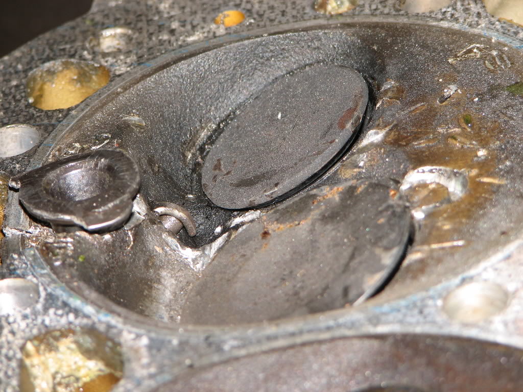

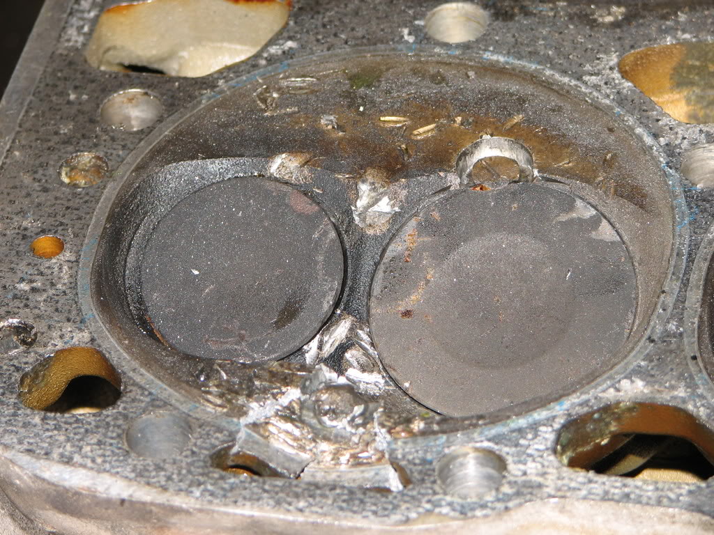

Pulled the other head off the block today, and immediately after it popped off, my eyes grew big. Check this out:

WTF is that metal piece? Carnage... that sucks man!

What the heck is that piece in the first picture????

It's a valvespring retainer. I'm thinking whoever had the car before me and my buddy bought it (he owned it before me), had it lying in the intake manifold, and after all this time it found its way through the intake port, and with the higher lift cam, finally squeezed its way under the valve, and caused that. I'm going to pull the oil pan off soon and see if the crank broke at all.. the harmonic balancer is messed up pretty bad. It's egg shaped, and all the rubber was somehow pushed to only half of it.

And yes, the piston is pretty demolished as well, almost as bad as the head.

Wow, never have seen a retainer get into the cylinder before - nuts and bolts are pretty common...

What is that dent by the intake valve caused by? Looks kinda like a flathead screw.
