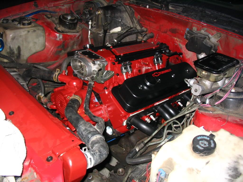

I searched and searched for this and can't come up with a good answer.
I rebuilt my 94 lt-1 (first timer) stupidly I overlooked getting the thing balanced with the new pistons. Didn't occure to me they could weigh any different or that it would matter.
So the problem obviously is I have a vibration but only 2k-3k RPM would this most likely be because of the rebuild or would I have vibration all of the time? I was under the impression that crank unbalance would cause worse vibration as rpm increased...
I also put in a new clutch set so I'm going to drop the tranny and strip it down to the flywheel just to see what I get.
