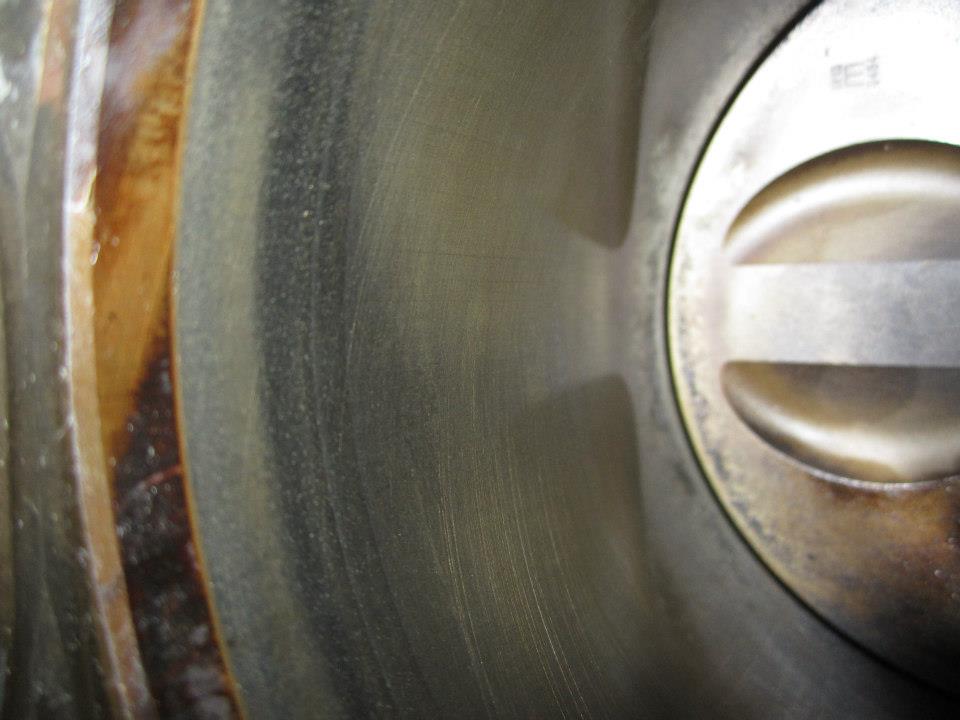

Ridge Reamer? you've obviously never had a LT1 or any relatively current 350 SBC a part. The last ring ridge I saw was from a late 70's early 80's "lightweight" 305
Here's a pic of a 150,000 miles lt1 cylinder

Originally Posted by cardo0
I bought my ridge reamer to get the pistons out of my original LT1 out of my '94 with <135K mi. So what u are telling me is a total farce as the pistons were stuck without it. But hey thx for sharing your pix.
Must have been a unique situation - most modern engines come apart at 150K+ with barely a perceivable lip, I haven't seen a bore worn enough to even consider using a ridge reamer in over a decade. Ridge reamers were used to keep from potentially damaging the ring lands so that pistons could be knurled and reused, but nobody reuses pistons these days so it's a pointless and time wasting labor operation.
