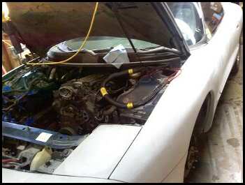

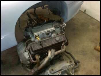

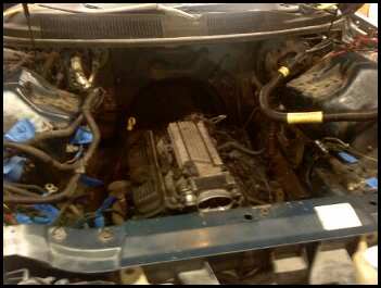

ok so i finally dove in and dropped the motor out the bottom today. i just dont get why people are putting the car so high in the air. i used one jack stand on each side, and the were not fully extended, about half...
i did take the wheels off, simply to gain another 6-8 inchs of clearance, put the floor jack under the k member, pulled the bolts and let her down, then got the jack out from under it so it would lay flat on the floor. then i did used one of my own ideas and took it out the side. my space in front of the car was limited, so i figured i might as well try it. and it actually worked great! it took only 2 guys to slide this thing around, and i thought it went very smothly. now its time to start cutting wires, and cleaning up the bay, and saving lots of money
