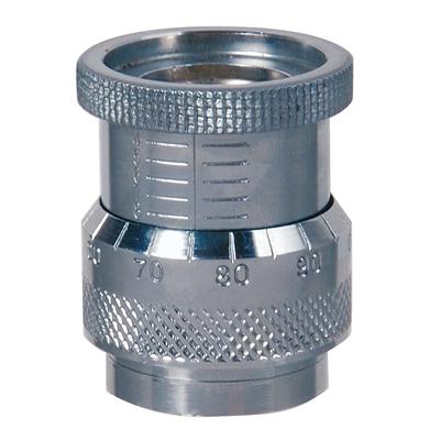

So what does the installed height have to be? Does the Crane kit (1308) come with shims?
Old Nov 17, 2008 | 11:02 AM
camarobird92's Avatar
Joined: Oct 2008
Posts: 254
From: Tulsa,OK
There is a tool that measures installed height of springs. You have to find out your installed height. Then based on what your spring preasure needs to be, you use different shims.
Old Nov 17, 2008 | 12:35 PM
Stl94LT1's Avatar
Joined: Apr 2006
Posts: 1,083
From: O'Fallon, MO
Valve spring micrometer.
Old Nov 17, 2008 | 01:10 PM
Joined: Oct 2008
Posts: 254
From: Tulsa,OK
Yah!!! That's the tool!!!!
