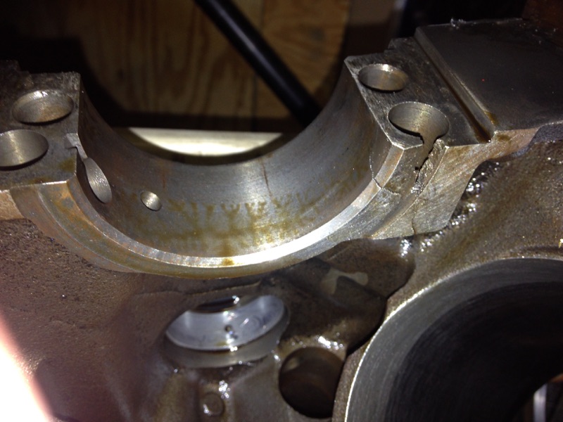

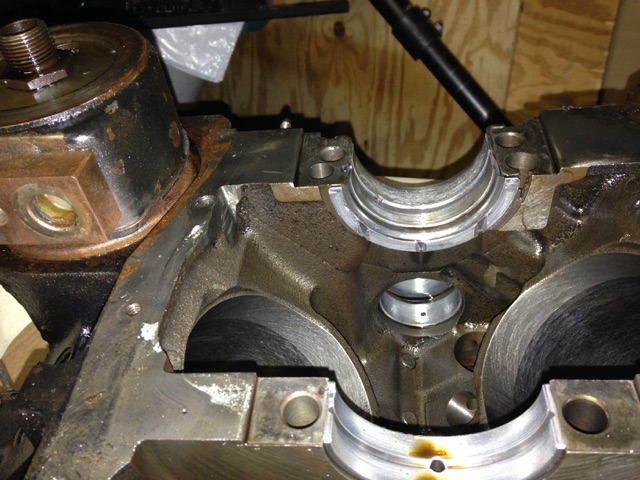

Has anyone had their block crack in the same place? Got any ideas on what could cause this?
It was a 383 with eagle crank, stock rods, and speed pro pistons. I bought it that way and it only lasted about 6 months before it started knocking. I finally got around to taking a look and i found this (among other things), which I think was the source of the knock.

could have been several reasons the block cracked there in the rear
bad line bore for crank
running external balanced FW/Flexplate when engine was "internal" balanced (if it was)
eagle cast crank
that block is scrap, start over with better "forged" parts...and build

i already got another block. the crank was not damaged at all, all journals mic like new. i wish i knew what the previous owner did as far as balancing goes. i dont think forged is necessary for my purposes though.

if your Eagle crank is forged, it is "OK". Their cast stuff, no.
have a qualified shop prep the new block and balance rotating assembly "internal" balance aka neutral. You will need to run a neutral balance FW/Flexplate.
who knows wtf PO builder did but something FUp'ed

Wow, have never seen a block break there before. Thx for following up and sharing.
Yeah, that's a new one for me too - somebody did something stupid.
