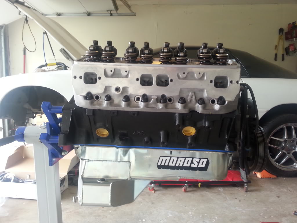

Just got finished with a long day in the garage and wanted to post a couple of pictures of my build with CZ28.com family. It's an old LTx, but she should move. She's been down since 2006 when I snapped the clutch fork and got the bright idea that if I was going to pull the transmission, I should probably just get the motor rebuilt too.

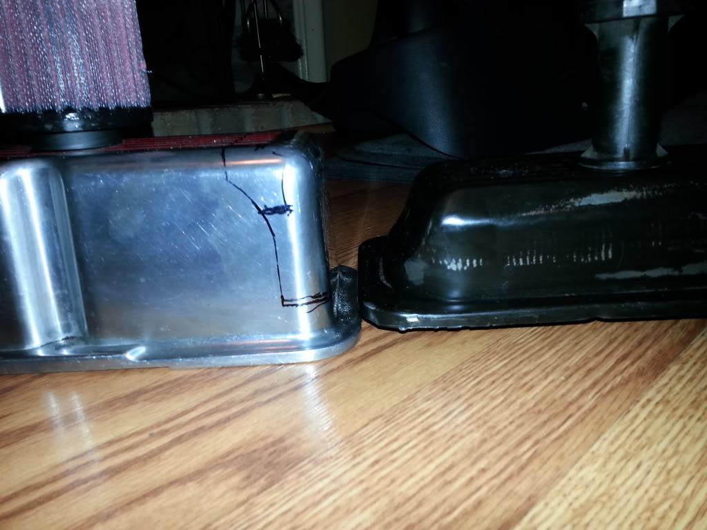

I really enjoyed the slideshow but I didn't see where you mounted your alternator. I'm planning on using the old Micky Thompson valve covers with my shaft rockers.

Thanks. The alternator is in the stock location. It wasn't on yet in these pictures because I had to modify the valve cover to fit. The standard unnotched SBC valve cover contacts the alternator and even grinding the back of the alternator to the bearing didn't help (ruined the alternator actually). I ended up marking the vc and having a buddy cut and weld it. I don't have any pics of it actually cut, but here are a couple of the markup I did on it. The first is next to the stock notched LT1 cover for comparison.

Thanks much, That is what I was thinking also but if there was an easier way then I'm all ears. How did the finish valve cover work out for you and would you do anything different?

Some people say they've gotten away with grinding the back of the alternator down, but that had no chance of working on these. Cutting worked out fantastic and wouldn't do it any other way. When you mock it up, make sure to account for clearance for the rockers as well. That's why mine arcs instead of angling straight back.
