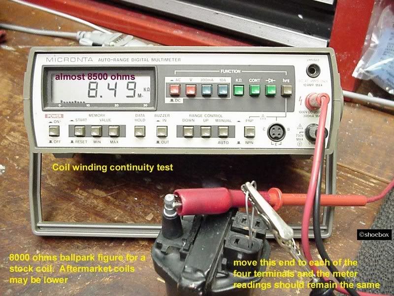

If you have a volt meter do this, this will tell you if the coil is bad
So appx. 8000ohm's is normal for the stock coil altho it may actually be lower than that... the MSD will be lower than that and put out more power
