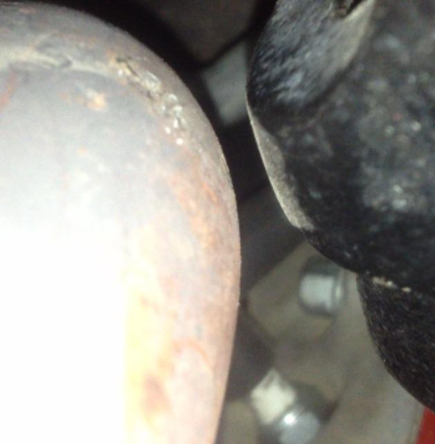

Im looking around. Gonna check this out today. It looks like it maybe makes contact when i rev.
Its a header tube and motor mount clamshell on passenger side. Gonna see if i can see it hit or something idk.

Just checked that mount and tube out. It's not hitting.
Could it be the passenger Heatshield directly ontop of my header? It's vibrating on top of my header and if I push up on it, it stops.
