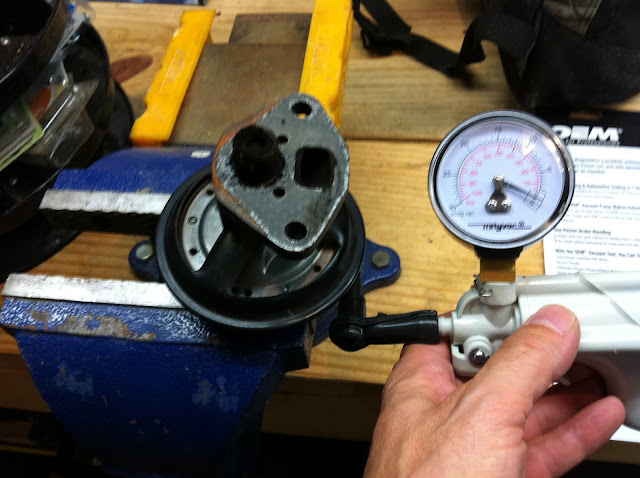

Well, off it came...
Testing on and off the car shows no vacuum held (see gauge). Online an EGR valve is $75. "My price" at my local dealer $125. What BS. Does anyone know if the valve comes with the gasket, or do I have to order that too?

You can get one anywhere it doesn't have to be a GM
