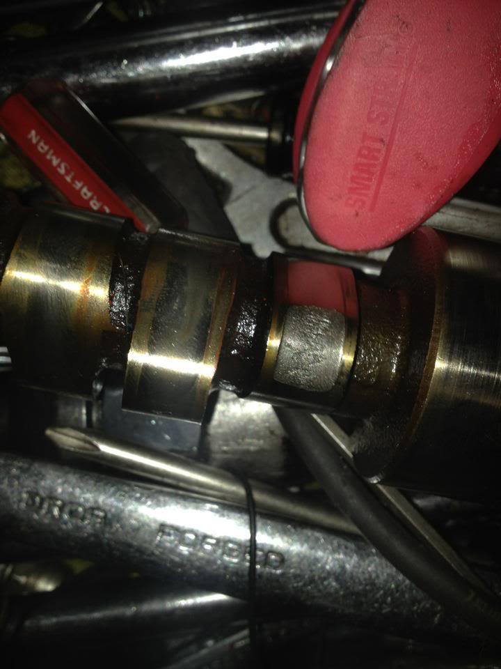

This is on the TPIS that was in my car, could this have caused problems?

Old Oct 29, 2012 | 12:18 PM
ACE1252's Avatar
Joined: Mar 1999
Posts: 2,068
From: Kernersville, NC
Re: Cc503 vs my TPIS
Ohh man.....
Does the rest of the lobe look normal? If so, I'd guess a heat treatment problem from the manufacturer. Nothing but junk now.

yes rest of the lobe looks normal its on 2 lobes,

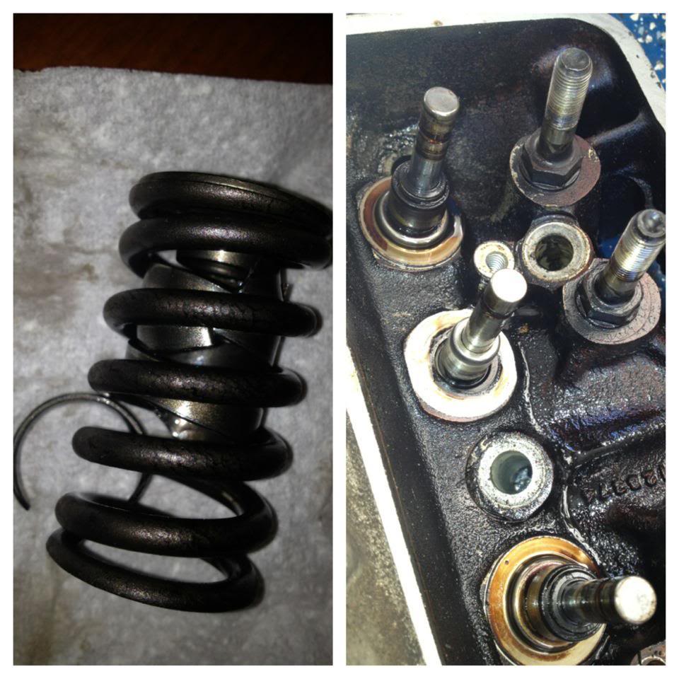

and guess what i found when i took old springs off. one with a broken inner spring and what looks like I dont even have a valve seal. Could this have been why my car seemed to of lacked power and burnt oil on the down rev? (There is a spring cup, its just not in the pics)

Old Oct 29, 2012 | 06:42 PM
lt1-xjs's Avatar
Joined: Dec 2005
Posts: 426
From: Dayton, Ohio
Glad to see you found the problem and I'm sure it would hinder the performance. Thanks for sharing the info.
