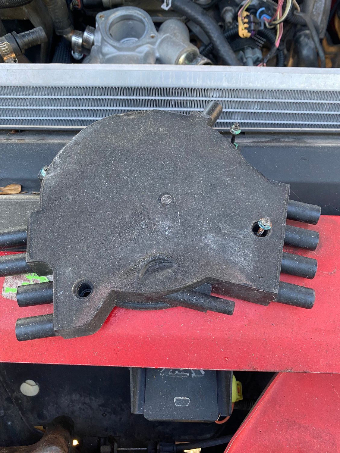

So I did some digging. Remember, this car was at the paint shop for about 3 months. I started looking through some of the progress photos. IT spent a Month outside with no hood, bumpers, fenders or quarter panels. I have a feeling this is all due to sitting in the elements.

Update, Either at the Paint shop or the Mechanic's shop the car caught fire. I found a burnt wire harness, and what turned out to be fire extinguisher powder in several nooks and crannies. I had been all over this car before Paint and I KNOW there was not previous Fire damage. Unfortunately it has been to two shops since, one to replace the Fuel pressure Regulator and one to replace the Flywheel.

As the former owner of an LT-1, I would suspect that the water and/or extinguisher used in the fire has now put your OptiSpark into the grave. Old fuel did not help, of course, and the junk in the fuel system shows poor maintenance.

I would say the fire was definitely the cause. The cap looks like it sustained ALOT of heat. And it is NOT a delco unit. (But thats another head scratcher)
