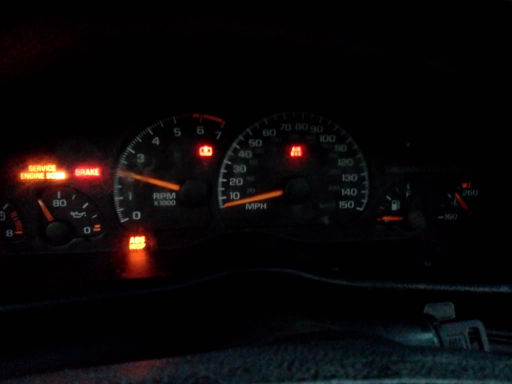

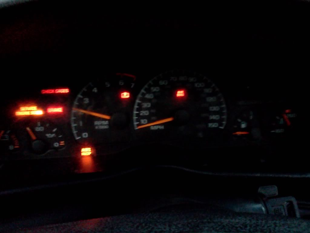

it smokes from the side where the rad cap is and it looks to be coming from a low point...
should i just say screw it and replace the radiator?????
ill pressure wash the inside of the radiator and see what comes out.... i hope its just a clog.....
but heres pics of what the dashtells me.....
someone give me some help, a checklist of possible things, anything.....

Old Jun 26, 2011 | 10:36 PM
Posts: 71,114
Re: car over heats and dies HELP!
Does your oil pressure gauge always read at the max above 80psi. Typically means the wire is off the sensor, or the sensor is deceased. And you drove it at 155MPH with all those lights on? Plus it still needs fuel. Kiss your fuel pump goodbye.
Does it idle at 2,000 RPM or did you have your foot on the throttle?
Was the e-brake on in those photos? If not, the "BRAKE" light is indicating you have an unacceptable pressure difference between the front and rear braking systems. That in turn would turn on the "ABS INOP" light. Or there might be a whole 'nother set of problems turning on the "ABS INOP" light. Only way to tell is to have the EBCM scaned for codes, which requires a high-end scanner like the Tech-1 or Tech-2 that the dealer mechanics use.
To turn off the low coolant light, assuming the leaking radiator isn't really low, unplug the sensor. If its on because of the leaking radiator.... well.....
thats weird because my ABS INOP only comes on once in a while and my Coolant light is always on and wont ever shut off, unplugging it would be my best bet?
