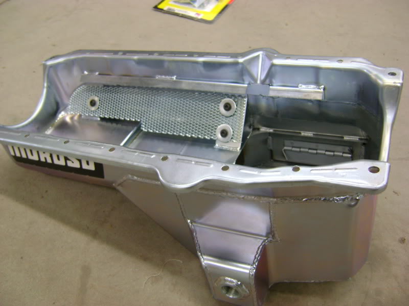

I got my Moroso pan and pickup today and i'm impressed with how it looks. The Moroso and Canton pan are very similar in design.

I have heard that the Moroso is a knockoff of the canton. Moroso being part of a bigger company, might have tighter QC.
If you have the time, please post pics of it also.

I will be installing the oil pan tomorrow and will post up some pictures.

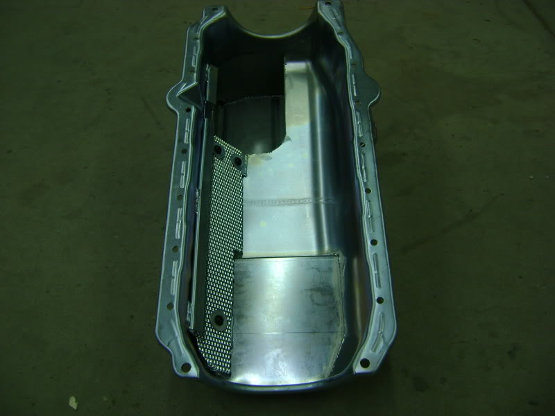

Pan is installed! I'm letting the RTV dry overnight before starting it. I had to modify the pan a bit to get the pickup to fit, but overall I am happy with the fit.

Pressure drop is fixed!
