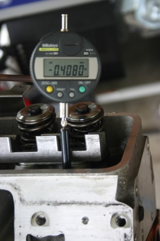

Yep, like stated above. Use a dial indicator and set it to zero on the lowest part of the cam. Rotate the engine until max lift is shown. Multiply that figure by 1.5 or 1.6 to get your valve lift. I use 1.6 shaft mount rockers. In the example below....my dial indicator shows .408 lobe lift. If I multiply that by 1.6 I get .653 lift at the valve.

You should never take the lift and duration measurements at the retainer. Hydraulic lifters will give you erroneous measurements everytime. Just like degreeing a cam you MUST take the measurement at the lifter with no preload or pressure on it. Meaning the pushrod must be removed.
The method above using the pushrod with no rocker is a way around taking the intake off but be very careful how you setup the dial indicator becuase if it isnt set in a manner that maintains proper geometry then your going to get another bad measurement.

Yep.
The dial indicator in the picture posted is obviously not parallel to the push rod and that induces a cosine error, lobe lift is actually more than is being shown on the gauge.
