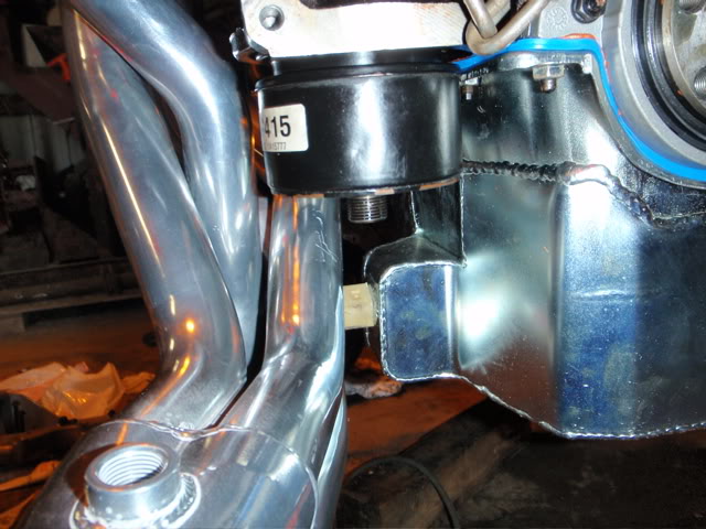

both of those will need to be modified if u are using lt headers, thats if u want to use the oil level sensor.
this is what i did.
if you have a high volume pump and rev over 5500 rpms i would say it would be safer to go with a larger pan.
the 50 buck pan is probly thinner cheap metal from china. use at own risk. i would go with oem or brand name that is at least oem equivalent. that me though. lol
