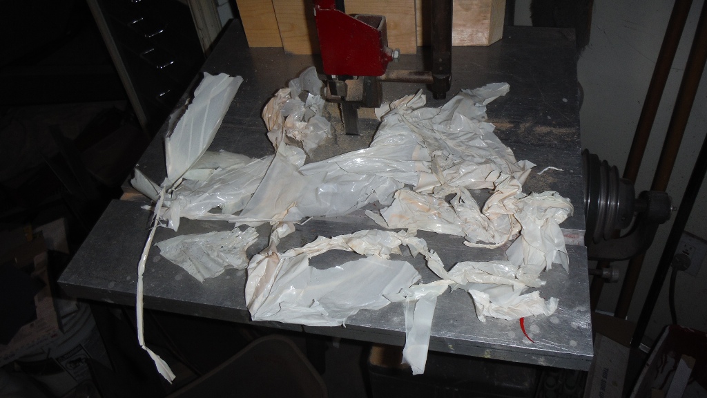

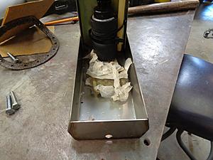

I have found a smoking gun on why the engine shut off and it's not the Opti. When I was building the custom aluminum fuel tank it had a couple pinhole leaks after I had put gas in it so I was reluctant to weld them up. Someone suggested I use a Bill Hirsh gas tank sealer so it would plug the leaks as well as protect the inside of the tank from the alcohol in the gas. BIG MISTAKE! The sealer has been peeling off the walls of the tank in sheets and some of it made its way to the sock filter on the fuel pump. I know it blocked the flow because the material right around the pipe to the pump was sucked down tight against the pipe and filter sock. The rest of the debris was not as firmly attached and so floated away as soon as the pump was shut off allowing the engine to restart.

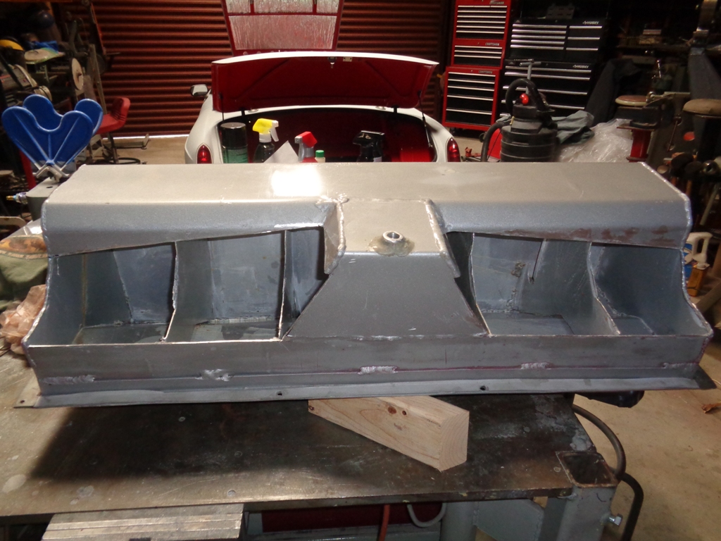

I cut the tank open so I could access all the areas of the tank and this is what I pulled out
I called Hirsh and was rudely told that I must have done something wrong and it was my fault even though I followed the kit instructions to the letter. Lesson learned - Don't buy Hirsh products and don't use tank sealers.

Originally Posted by LT5
Well as far as the gas tank thing, that blows major *****. Why did u use an aftermarket gas tank anyways? Just wondering maybe to some advantage?
It's not an aftermarket gas tank, I had to fabricate the tank myself. It is in a widened MGB with a blown LT1.
