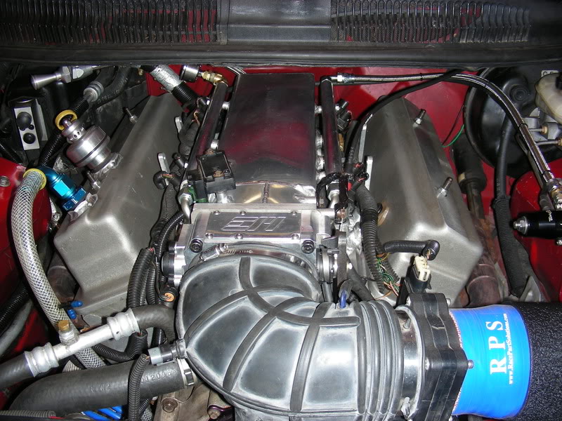

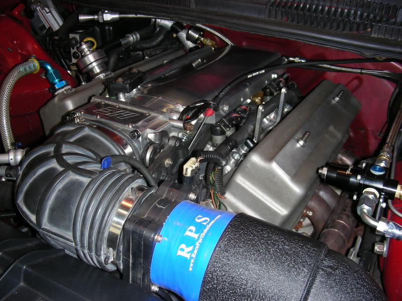

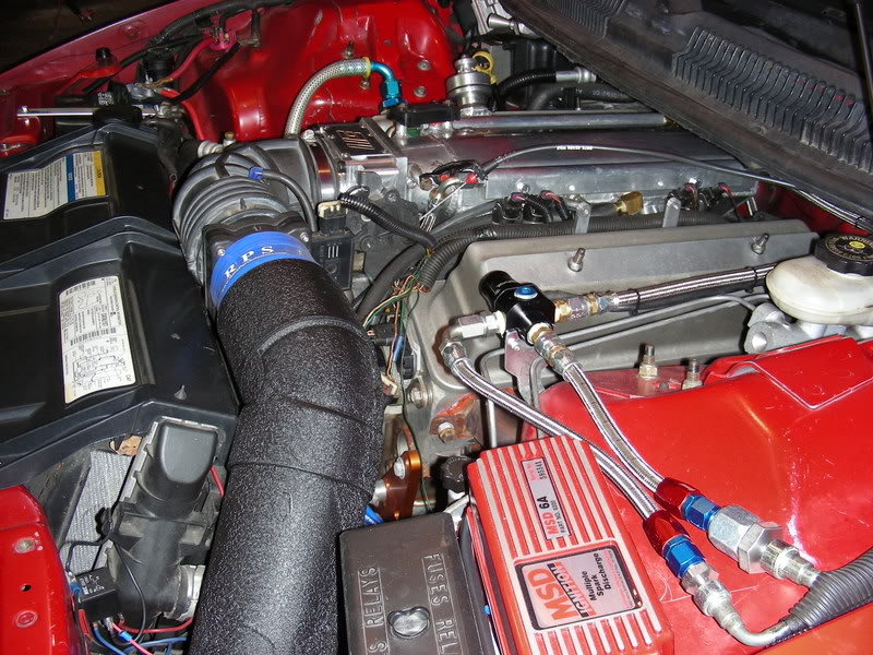

And you have a large open wallet?
This is my setup:

Old Oct 13, 2008 | 08:45 AM
slomarao's Avatar
Joined: Mar 2004
Posts: 2,705
wow, thats a nice manifold.
user 647483's Avatar
Joined: Apr 2000
Posts: 1,444
This is my setup:
Sexy ... Any idea how well it worked VS the stocker (or even a ported stocker)?
