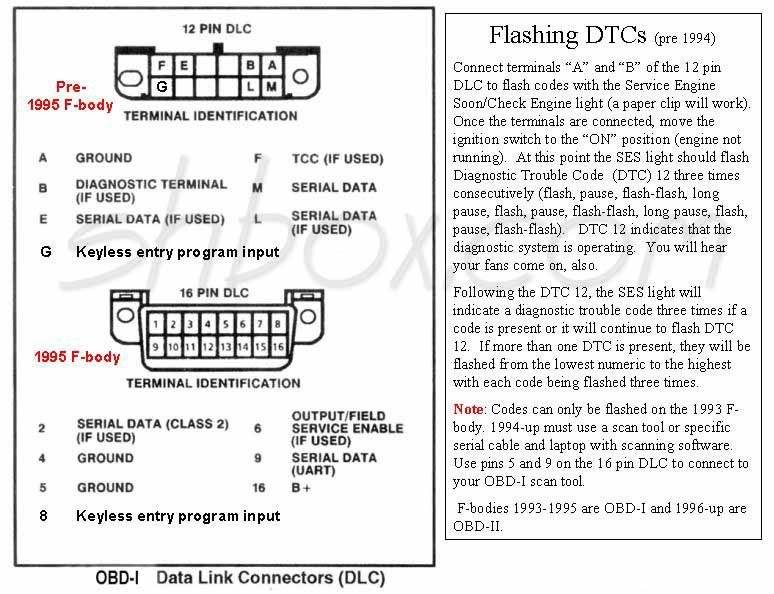

I saw your post last night, and was going to ask if you had scanned it for codes. But I didn’t know if the 92/93 Corvette ECM could be scanned by shorting the ALDL pins like the 93 F-Body. From my reference (“Corvette Fuel Injection & Electronic Engine Management”, Charles D. Probst, GM Part # 12497977) it appears that does work: Here's the 93 F-Body instruction:
http://shbox.com/1/dlc2.jpg

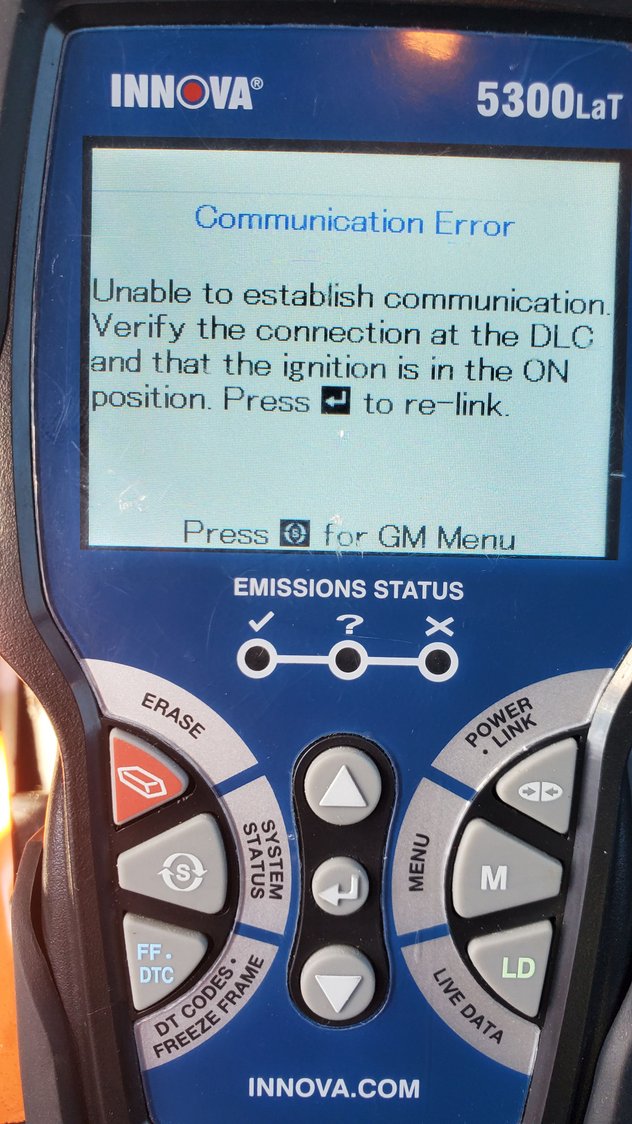

the shop scan tool FAILED TO MAKE A CONNECTION etc...

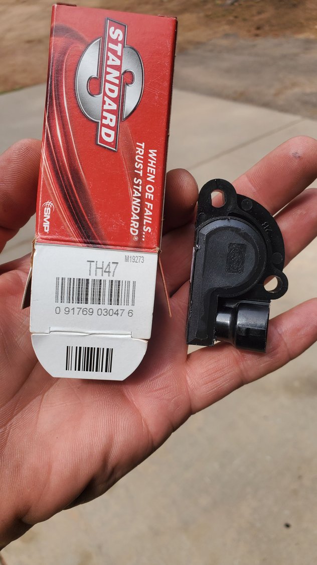

I did replace this but it didn't solve any issues

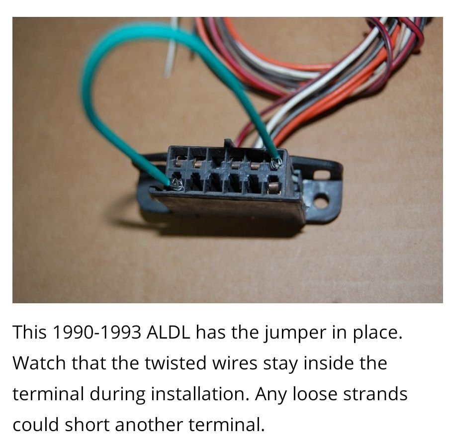

Found this on corvette central. Is this correct?

Doesn't match the F-Body. Did you even look at the link i posted in #3 above. My Corvette manual indicates the F-Body is the same as the Corvette with regard to pins A and Pin B. Pin A is the ground, and pin B is the ECM diagnostic request. The Corvette manual show pin G (lower left corner in your picture) is for the Fuel pump. Just illustrates the problem of trying to equate the Corvette LT1 to the F-Body LT1.
In your photo the pins are:
F-E-D-C-B-A
G-H-J-K-L-M
That show jumping A to G.
F-Body:
Old Jul 13, 2020 | 01:52 PM

Yes I did read it and understood the FUEL PUMP is located there. I watched a Video on a 92 vette. Jumping A to G. Cleared several codes and started fresh. The digital dash prints out the codes without having to count flashes. Cool.
