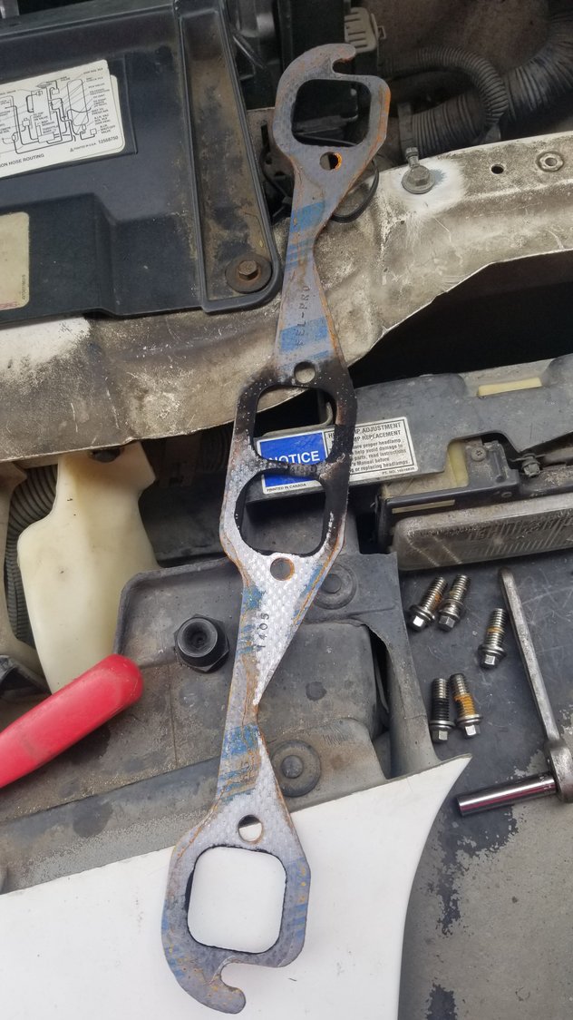

Re: 97 lt1 missfire on #7 i need help!
Just want to update this thread.
The problem was a header gasket leak on the driver side
Of cylinder 3/5
Also had the wrong gaskets on there maybe the reason it started leaking. I had 1405 felpro instead of 1406
1405 is a square portso they actual fit small on the exhaust port.
So about the gasket leaking out the bottom of the flange where it wasn't visible and only with time it got noticeably louder till i decided to take the header off to inspect.
Gasket was toast so replaced it and now motor is running good.
Misfire is gone and no loss of power as i can tell .
All this trouble caused by header exhaust leak
Hope this helps to others in taking close look and inspecting for the smallest exhaust leak before the O2 sensors .
They can cause havoc for you. Lol
