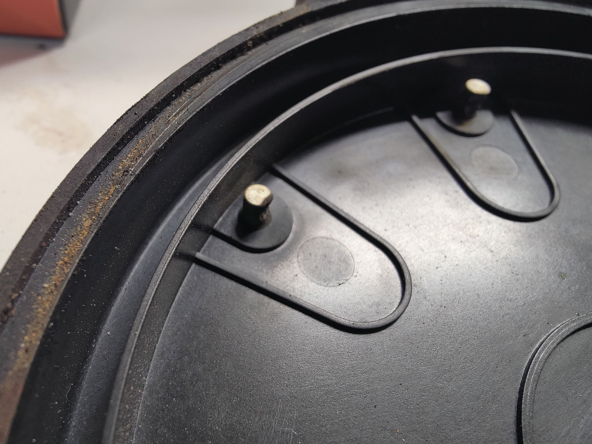

Tore it down today and go to the opti. Cap points were pretty chewed up. Rotor was secure and had some corrosion on the end. Replaced both and cleaned the sensor and disc. Installed the opti kept everything else off just to test it. Connected all sensors and the car still does not start.. Does the same exact thing. Great spark at coil. I have spark at the plugs now (thinking back I may have checked for the spark at the plugs backwards last time) cranks for awhile then it might try to start and stumble. I'm not sure to go now. Dont know if I should leave it apart. Very frustrating.
Did you take any pictures? Did the Opti have a Mitsubishi optical sensor in it?
What brand of cap and rotor did you replace it with.

Yes. It has the Mitsubishi sensor. I replaced with the accel one. Today I'm going to take the opti back out and spin it to see if the injectors are pulsing.

Definitely cap and rotor time.

The Accel Sensor is Trash!
your better off cleaning the Mitsubishi sensor with 99% isopropyl alcohol and reusing it.
