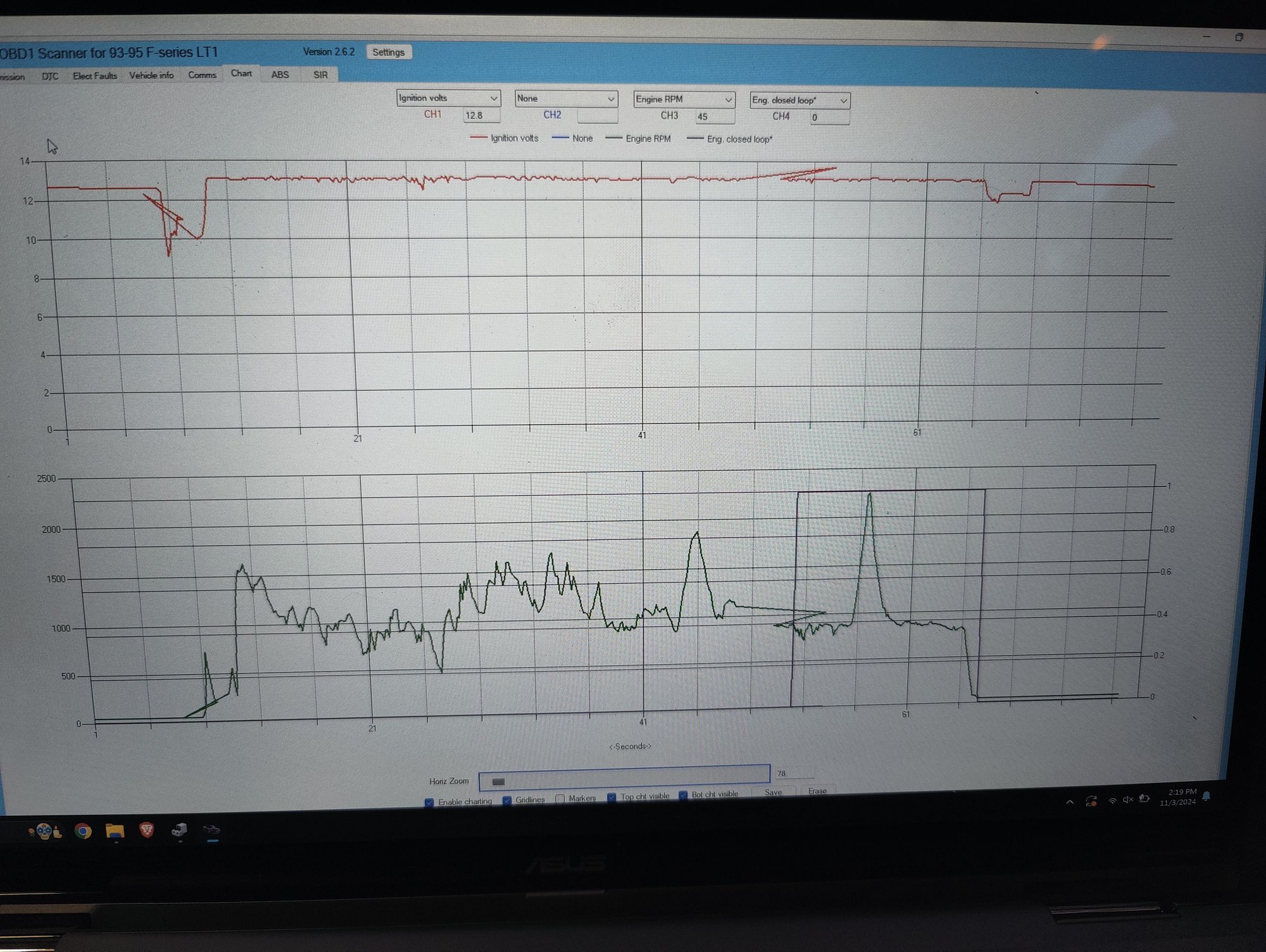

Hooked up scan9495 ran the same ignition voltage and tps volts. And saw this. I shut the car off around the 360 second mark and put the key in the run position to monitor the voltage after shutdown
The voltage spiking in the 20s still but no crazy drops to 0.

Here's how it ran for close to an hour. Went into closed loop dropped out sometimes while idling
I then made it home shut down and cleared the dtcs everything cleared fine. I went to restart and the car was not having it at all.

I'm wondering if you have excessive interference on the wire to the DLC. I never use the chart option, but it's easy to spot the impossible/false data values in a complete data log. Will also typically produce spurious random DTC’s that only last for one frame.

Today i recorded what the car was doing. Startup seemed fine at first, then it continued to sputter and pop and drop rpms. i included the 2 runs that it did
