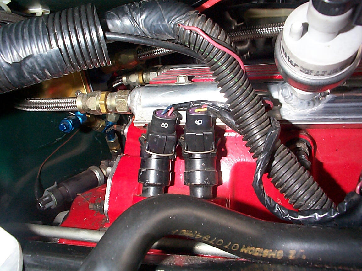

You should see the numbers 1 thru 8 on the injector harness connectors. Starting at driver's side front 1, 3, 5, 7. Starting at passenger side front 2, 4, 6, 8, These are the stock 6 and 8 connectors on the 94 that I bought brand new in 94 and still have (probably one of the few stock/unaltered parts in the photo):
