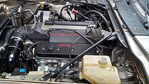

I used the 32143 MSD wires. Ran the wires from underneath and pulled them in close to the block with wire ties. No issues and you can't see them.

Your link was for #32149. Glad you found the one that you needed.
The pictures of the engine compartment seem to be from a vehicle different than the picture of the Camaro shown in your first posting.

Gaedbo, I'm still chasing the correct part number for the "Over The Valve Cover" LT1 wires. The engine bay photos were posted by LT1-XJS and they are the underside plug wires. Still scratchin' my head.
