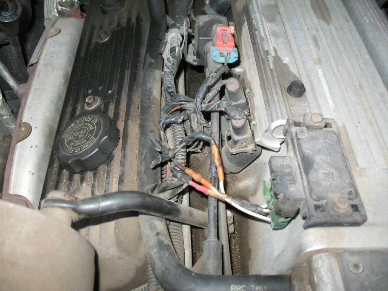

Here's an update. I was messing around under the hood looking at The MAP and the wiring (Injuneer mentioned this) and noticed the previous owner (or owner before him) either put a new connector on for the map or something because the wires running into the MAP have been spliced in to the main harness with electrical tape. I wiggled some of the wires and then when I tried to start the car it wouldn't start unless I held the gas down and then would die if I didn't keep my foot on the gas pedal. During this time the car was running crazy rich. So I went back and undid the clip from the MAP and put it back on, I also squeezed the electrical tape at all the splices and then it fired right back up and idled just fine. The SES light is now no longer on. So I'm thinking I need to either rewire the current mess or get a new MAP connector harness and splice it into the main harness. Any thoughts on where to get the new harness, dealership, parts store?
Here is a pic to help explain the wiring mess

The MAP reading is extremely critical on your 93 LT1 because it runs in speed-density. If the faulty kPa reading is 2X the actual manifold pressure, the ECM will calculate 2X the actual intake air flow, and will add 2X the required amount of fuel.

Thanks guys, I'm gonna go rewire my MAP now and see how that works. If not, then I'll order a new connector and redo it.

The link posted above does not work for me, but http://www.eficonnection.com/eficonn..._pigtails.aspx is a good place to get new pigtails. You can probably just fix what you have with some solder and heatshrink, though.
