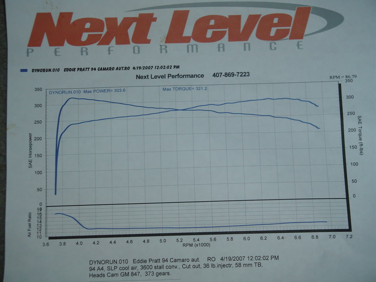

I have had both PCM4Less and MadZ28 tunes on my car for the same setup. Driveability is better with my MadZ28 tune over my PCM4Less tune.
PCM4Less tune:
303.6rwhp / 321.2rwtq - open cutout
12.7xx @ 109.xx on 1.8xx 60'
~11.3-12.0:1 air:fuel
MadZ28 tune:
307.07rwhp / 290.42rwtq - closed cutout
340.61rwhp / 322.35rwtq - open cutout
335.89rwhp / 312.98rwtq - open cutout
12.4xx @ 110.xx on 1.7xx 60'
~12.5-12.7:1 air:fuel
