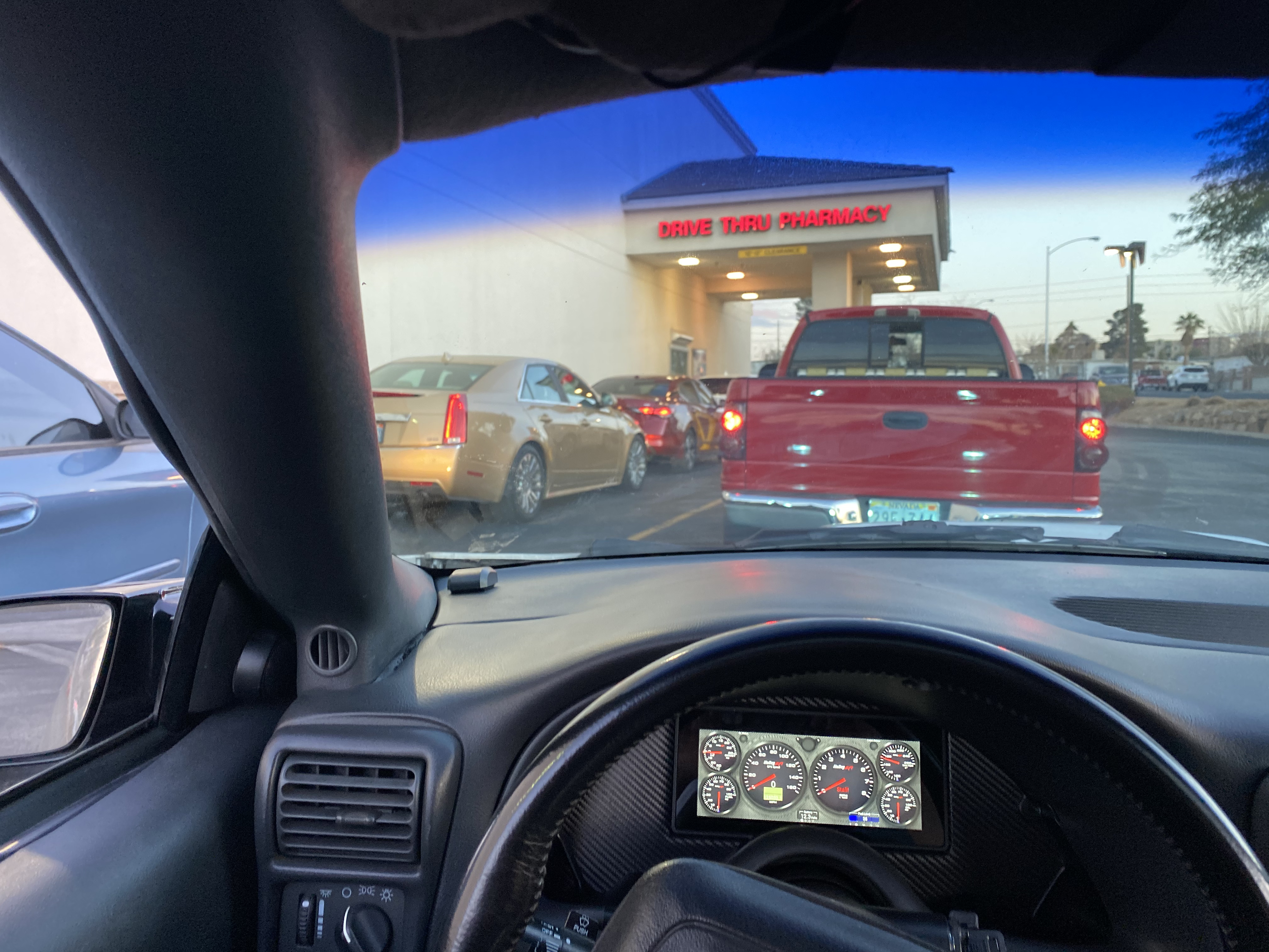

The Holley ECU is really pretty nice, especially coming from a stock ECU. Tunes upload in about 10 seconds, and there is not sitting on the edge of your seat questing whether or not your ECU is going to brick. The flexibility is pretty awesome as well, I have a version of the tune that triggers the EWP at 5% TPS so I can bleed the cooling system without the car running (with the car hot). The digital dash is also pretty epic.
