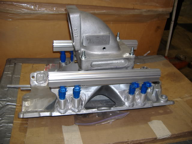

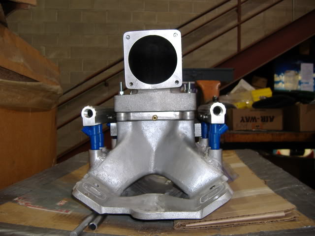

I have a brodix HVH set up for fuel injection but fogger placement is going to be a issue.
I sold the 39lb injectors that were in it I need a 45-50lb injector and the fast ecm's are a little pricy. I was going to do a dart block because of the times I want to run but then the LTx Shootout got going last year so I stuck with the LTx block, didn't have the money to mess with the fuel injection before the shoot out so a friend said I could use his carb. Ordered an intake and still wasn't ready for the shoot out. I should be there next year.
