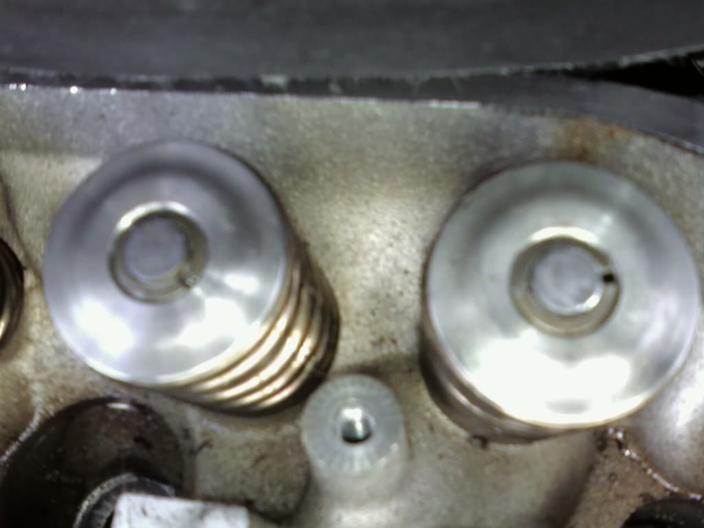

I bought some heads, they have these dual gold springs on them, they look to be either Patriot Performance Gold or PRC springs. They are made by the same company I know but how am I to distinguish the two sets? Is there something in them that have a diff color? Im going to pull a spring and snap some pics, maybe I can find a local performance parts store who can match em. Any help is appreciated.
I found this info:
Here are pics of mine:
Here are manufacturer pics:

So I see there is a diff in the locks, what will be the diff in the 10 degree versus stock valve locks?

5. Patriot Gold Duals: See Crane and 921’s. The PP Golds come on all PP heads. PP are the only genIII spring setup to use the super 7 10* locks.

PP, PRC, TEA, and all other "Gold" springs are all made from the same manufacture; Associated Springs. The differences are in the retainers and seat locators.
