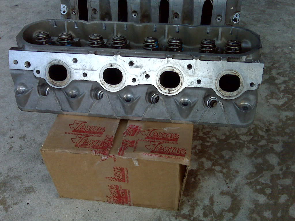

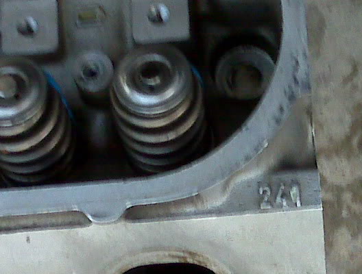

Ok this is what happen. I saw a set of heads on ebay and went ahead and bid on them. The description was from the texas-speed site and it said 5.3l 220cc heads. Anyways I went ahead and bid on them. The ending bid was 1000.00. 500 less then brand new. I got them today and they are 241 casting... The springs have a blue line. They are "suppose" to be good for
.650 lift. Im so pissed im ready to grab a flight to where they came from and kill someone... I was literaly shaking cause i was so pissed... The ebayer has 30 total feedback 100% positive. I hope this is a misundestanding and that im just an idiot. Here are some pics. anyone with ideas please help.

I got in contact with the seller and he says they were stock and he got them ported by PRC. He said he can guarantee they flow like said on ebay. Im want to trust him because he does have 100% positive feedback. I might get them flow tested.

But they aren't 5.3 heads and don't have good dual valve springs. They are not what he advertised.

Those look like comp 921 springs, good for 650 lift when new. Definitely not 5.3 heads though. Yuu probably paid about $400 too much for used 241's in my opinion. You can get new, ported 243's for a little more than what you spent.
-Geoff
edit: I think it was a 918 spring. Either way, base comp single spring.

Yeah he emailed me today saying that he swears up and down that he sent them to prc to be ported to the 5.3l specs from thunder racing. Im looking at them next to mine and looking inside and I honestly dont see a difference at all. His are alittle cleaner and one has 220 written on the side, but i cant see a diff at all. does factory springs come with a blue strip also? please answer back. I might go ahead and send them back.

I thought the factory springs had a yellow one. I am pretty sure those are Comps. Tell him to cough up a receipt.
Usually you can tell if they have been ported. I would call bull**** on the "5.3 220 heads". Those just plain aren't 5.3 heads.
Now did he say he was selling 5.3 heads or heads ported with the same program as the TR 5.3s? Porting 241s with a known 5.3 cnc program does not make them the same as 5.3s because of the chamber size.
