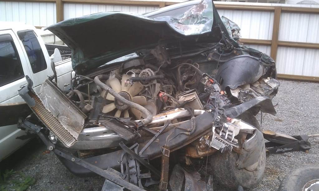

Gonna try to pull the 6.0 out of this mess... I'm assuming its a LQ9 block. I'm still not sure if its the LQ4 or the LQ9, so does anyone have any helpful info?

Depends on what kinda of truck that is and what you're doing with it.

It's a 99 2500. Just gonna pull the engine out for the block if its worth it.

That's an LQ4. LQ9 went into the Silverado SS, Ecalades, etc. Not the early 2500 trucks.

Early LQ4s like the 99 will have the much less desirable (worthless) iron heads. Later 01+ got the same heads as the LQ9, 317 castings. LQ4 got dished pistons, LQ9 flattop. Also on that engine, the crank length will cause problems in most applications - it's truck specific. Works great with a 4L80E, but any other trans and you will need to work around it. Manual trans?
Again, the only worthwhile part is the block if not damaged. It might make a nice 408 foundation.
