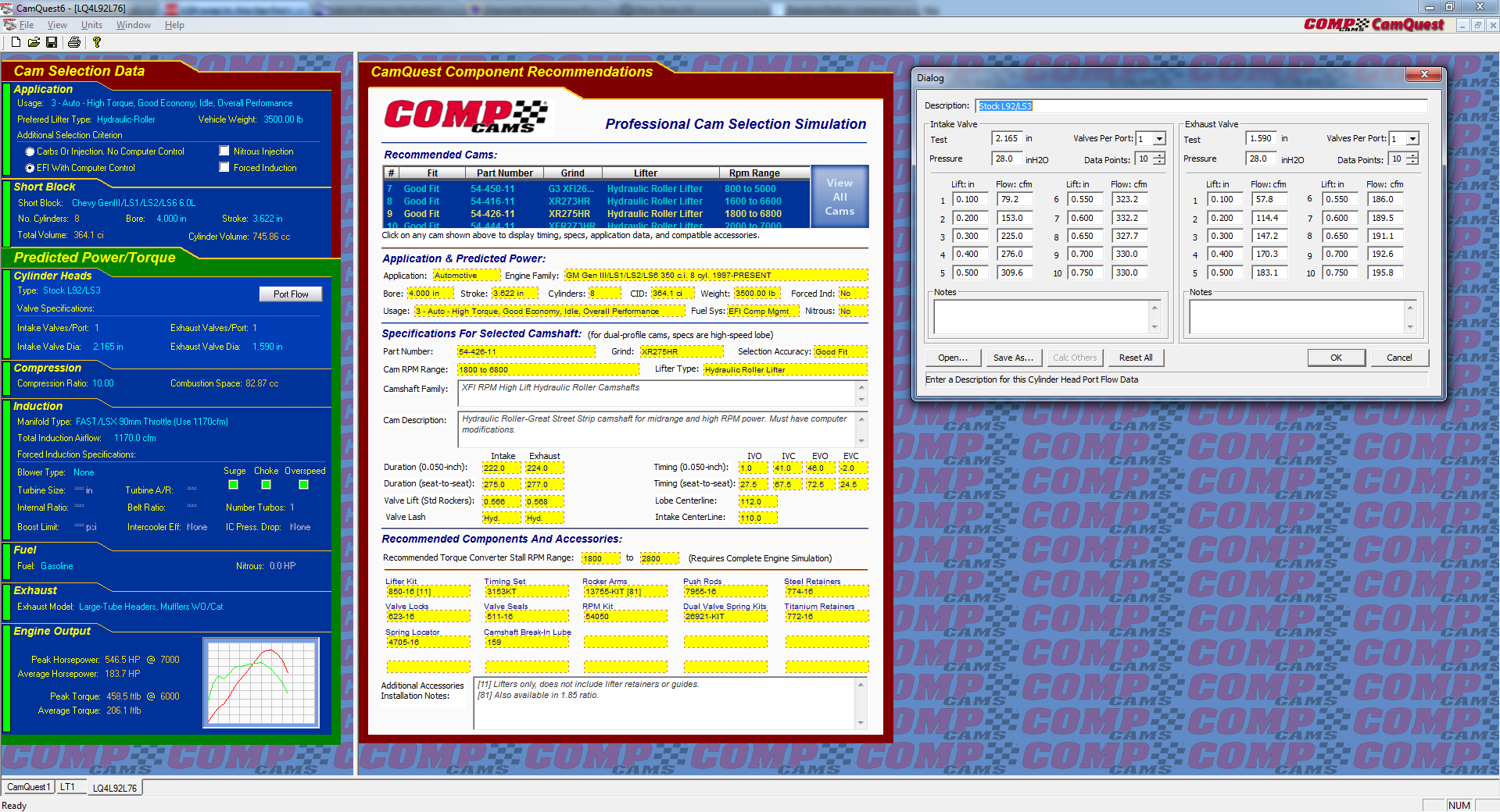

here's the CompCam calculator, I know i'll never see those numbers but it gives me a good idea of what the theoretical max is. (its really close for my lt1 /w hotcam)
I did see a cam close to those durations, but its listing it as a rougher idle and I would be using this care for street more than strip.
Click to view this image.
Actually it is VERY possible to see those numbers. L92 Heads, Raised Compression, and a Cam are absolutely no joke on the 6.0L engines... They become down right monsters for pretty much pocket change.
