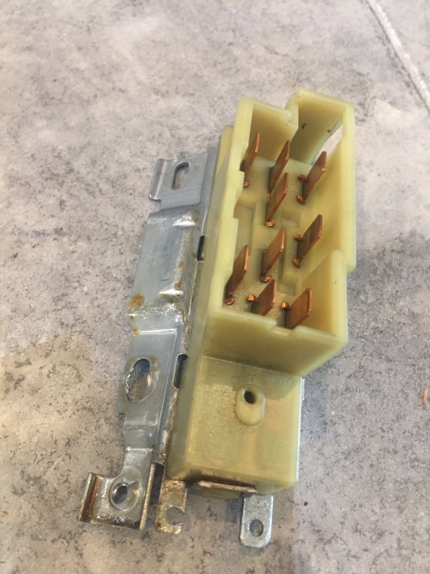

A strange thing i noticed was the OEM ignition switch had LOTS of oil on it. i took a pic and the oil is visible on the sides even after i had wiped it off and set it aside for a few days.
SS 01 ignition switch
