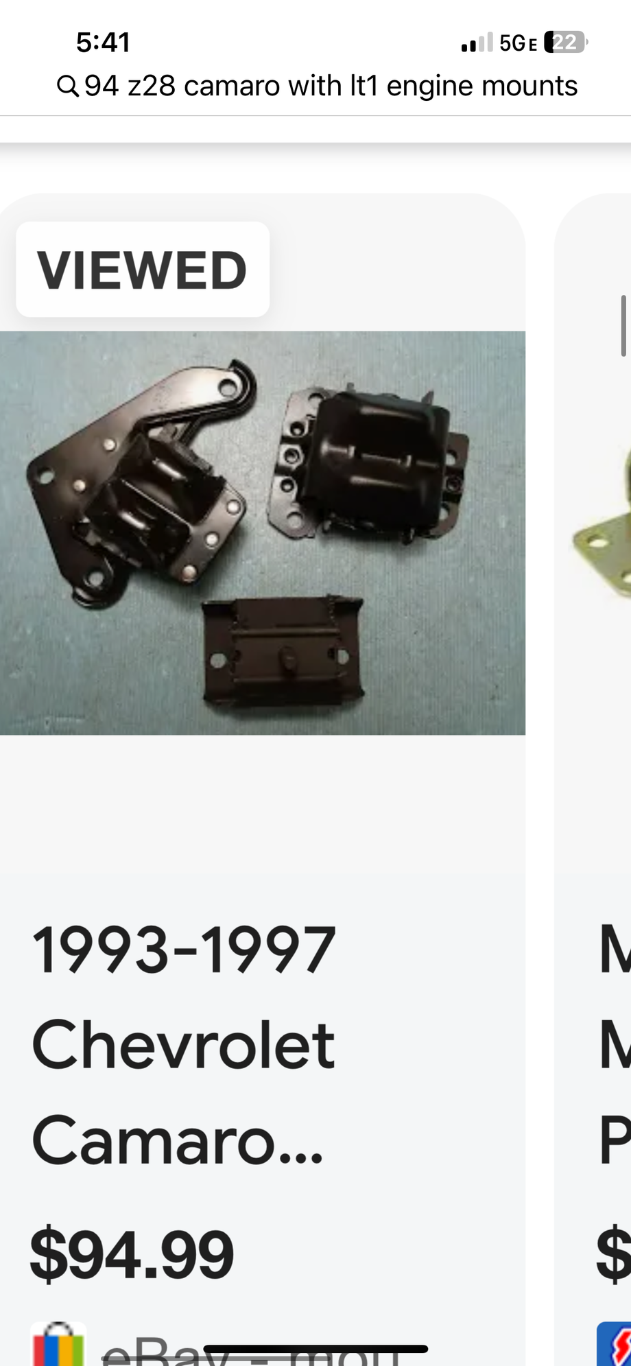

Hi guys I’m new here and hopefully posting in the right place. I just picked up a 94z28 roller and have Lt1 350 to go in it. The frame mountain the car are two different styles driver side is bracket style passenger is clamshell. Is this normal?? I got a set of engine mounts for the motor and passenger side is a clamshell type mount??? Should both sides in the frame be bracket type??

Looks right.
1993-1997 motor mount:
Per SHOEBOX parts list - excellent reference:
http://shbox.com/1/Parts.htm
22188799 LH
https://www.gmpartscenter.net/oem-pa...JjaCBSZXN1bHRz
22188293 RH
https://www.gmpartscenter.net/oem-pa...W5wme-TnnreMT-

I don't think he was in need of learning how to determine if he needed to replace the mount. He was asking us to verify that the left and right side mounts were different designs.
