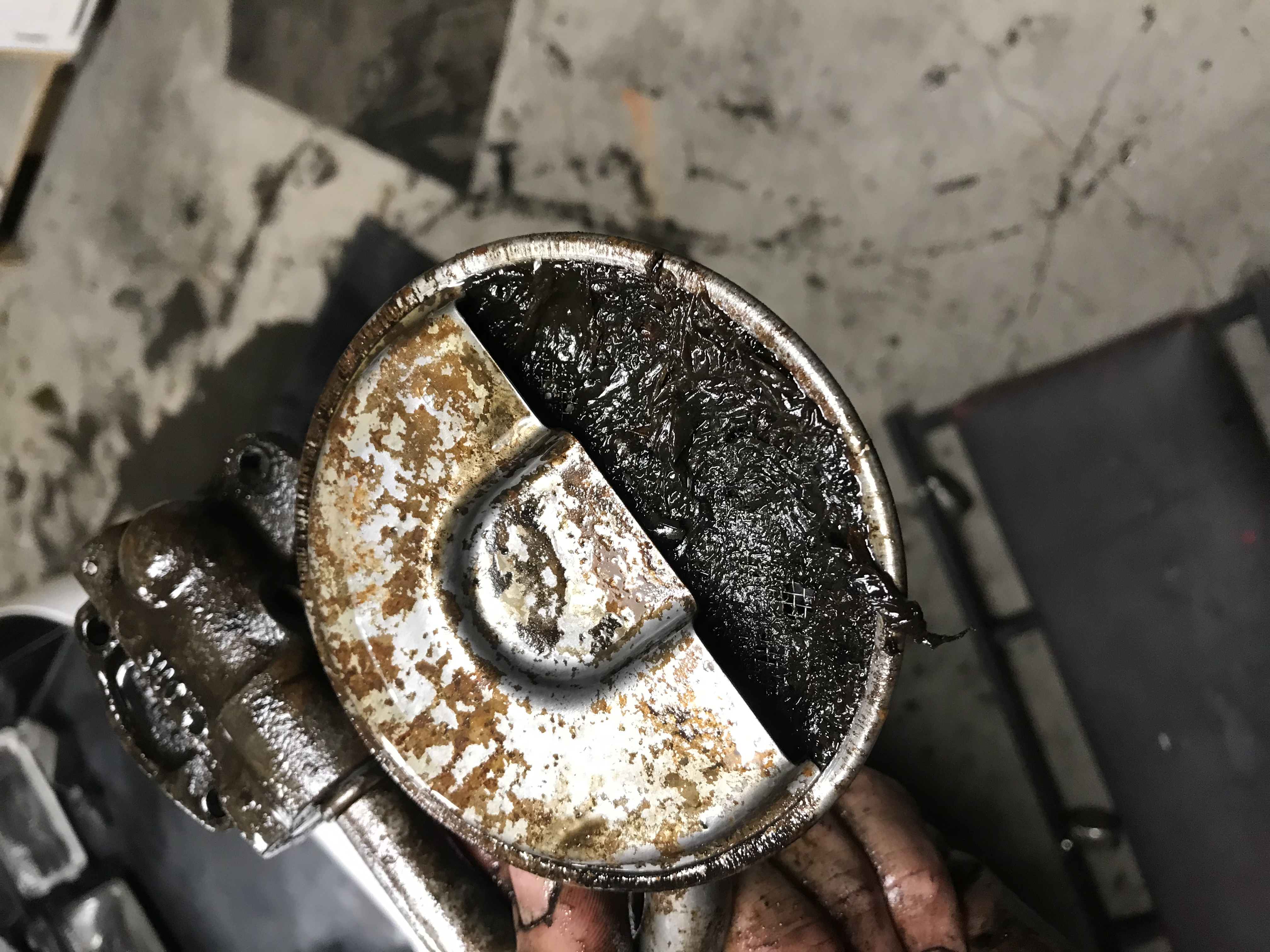

Alright so I posted previously that I bought the car with a blown head gasket and had been sitting so long it was seized. Well got all that straightened out and fixed and then ran into the issue of oil filter gasket being pushed out and leaking oil like mad (obviously shut it off immediately) then read about the spring getting stuck in oil pump. Well I lifted the motor and pulled the pan and pump off and sure enough it was caked bad and spring completely seized. Cleaned and replaced both and all is good after deleting the oil cooler as well.

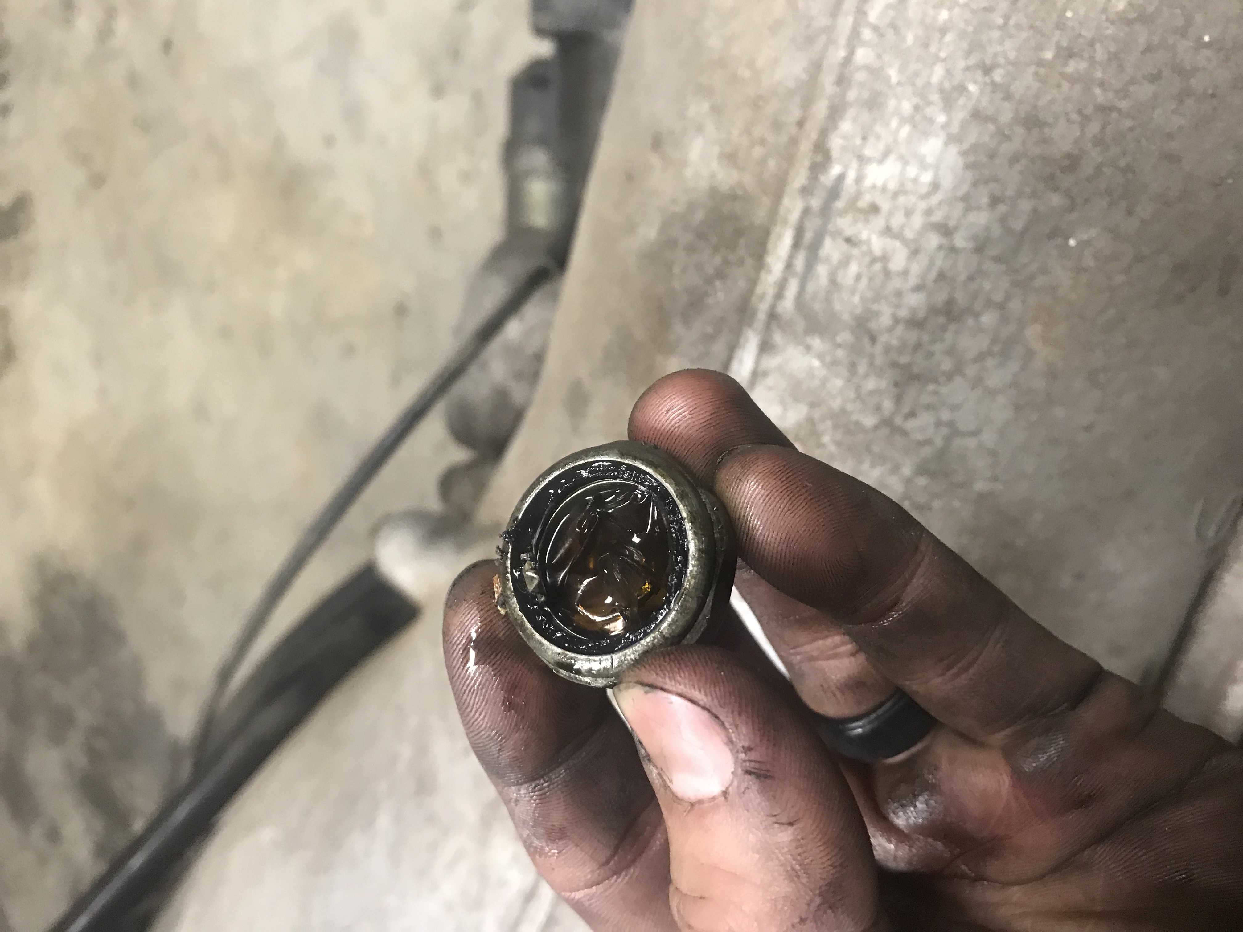

Well I’ll then I noticed the old (I believe original Opti 128k miles) ceramic coil connector was broke and spark arching. Replaced the Opti and it was all well again.

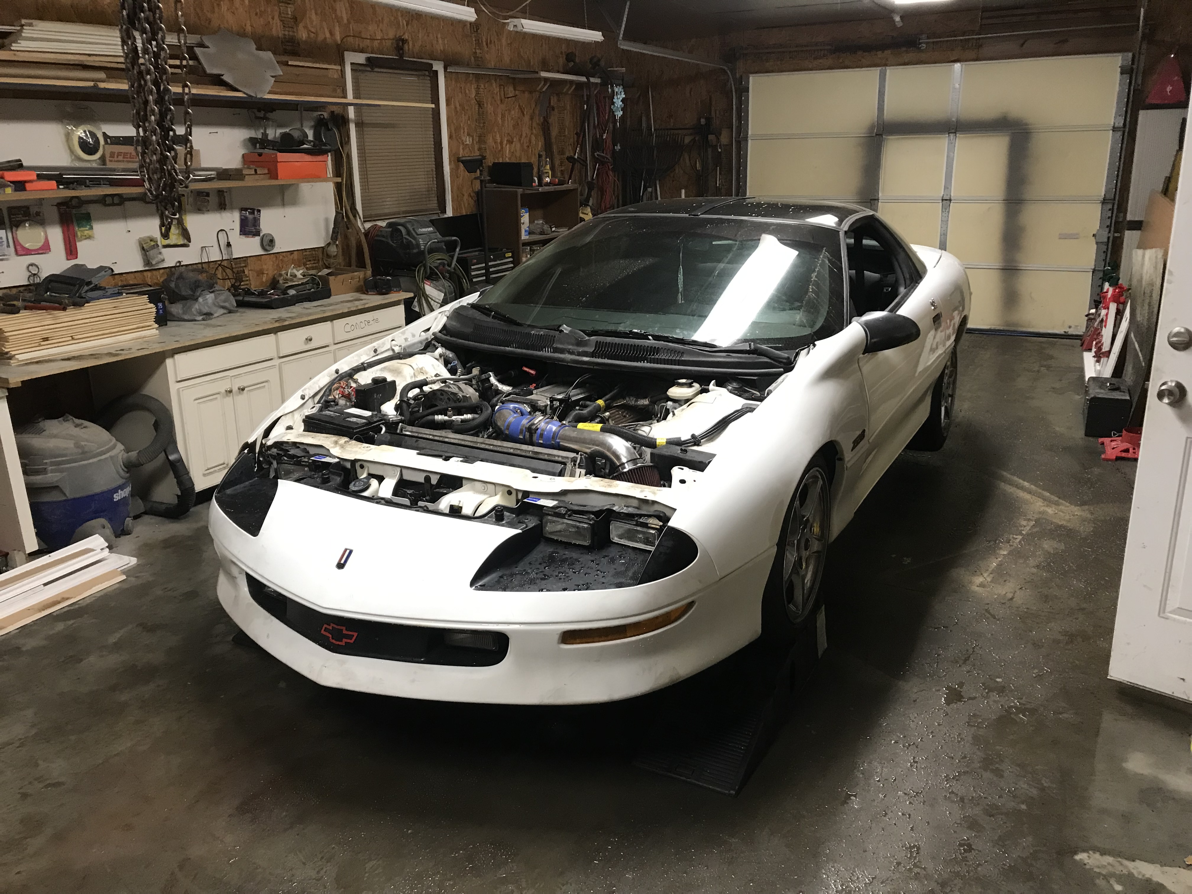

and while none of the work has been difficult accessing it on the other hand you all know is a diff story and I have documented EVERYTHING on video so if anyone is thinking about rebuilding one of these just please god know when people say it’s a pain........believe them
