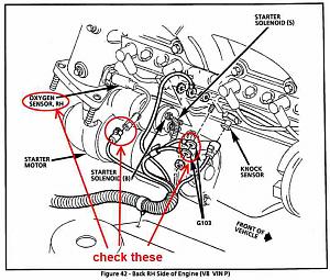

Check these points:
1. There should be two black ground wires just above the starter connected to the block. One is the ground for both O2 sensors. (right arrow)
2. Check the sensor wire also to make sure it isn't unplugged or broken. (middle arrow)
3. Make sure the sensor is installed. (left arrow)
The diagram is for a Firebird, but I think it is the same for Camaro.

I do remember the two ground wires were a pita and after header install this car has been pretty crappy...
