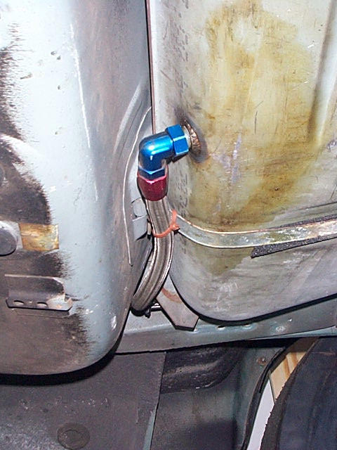

That's not the fuel tank - that's the floor of the hatch compartment. The fuel tank is in front of the hatch compartment, and above the muffler.
Drew has a photo of a plastic tank in this thread:
https://www.camaroz28.com/forums/lt1...l-tank-886314/
This is a photo of a small part of the bottom of a stock metal fuel tank. It's the only one I could find in all my photos of my car. Ignore the fitting and the line in the photo - that's added to feed a second fuel pump.

https://imgur.com/a/pRyd8 Here is a picture. It’s been awhile and I took this one just by squeezing up under the passenger side rear fender. The tank feels metal and is whitish like you said.
Old Mar 24, 2018 | 01:27 PM
DrewHMS97SS's Avatar
Joined: Sep 2003
Posts: 1,917
From: Las Vegas
Re: High Capacity Fuel Tank 97 Z/28
That looks stock. I have no clue how you are getting 17 gallons in it.
