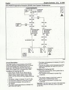

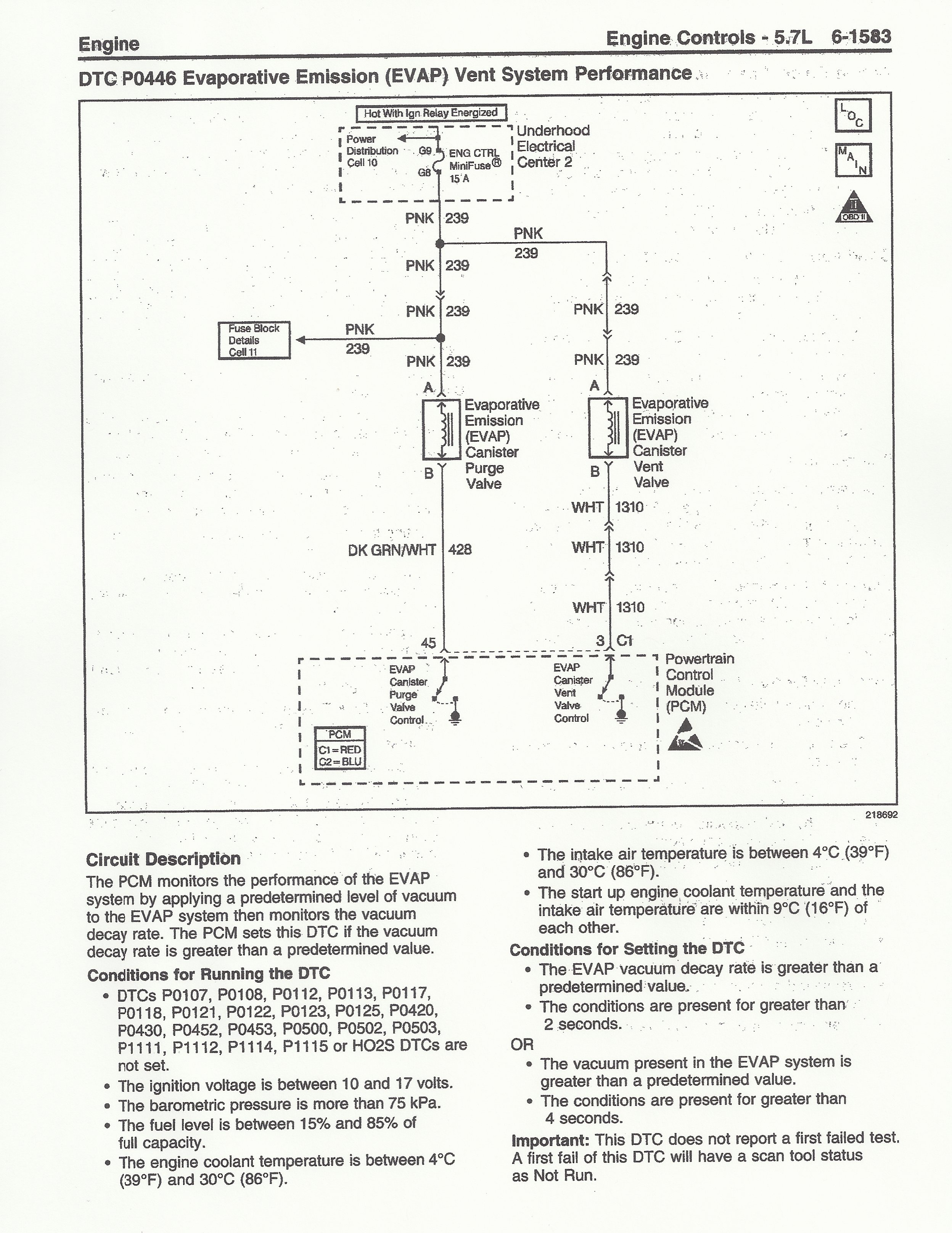

Appears you have the generic GM code definition, and that is not consistent with the actual P0446 code description in the factory service manual for the F-Body LS1 engine. I will caution that I do not have the 1999 factory manual, but I do have the 1998 and 2000 manuals, and they are identical with respect to this code.
P0446 = Evaporative Emission (EVAP) Vent System Performance
Rather than being a simple electrical issue on a solenoid circuit, it is a complicated test run by the PCM to determine the ability of the EVAP system to contain a specific vacuum level related to the EVAP system. The PCM runs a diagnostic that applies a predetermined level of vacuum to the EVAP system, then monitors the vacuum decay rate. The code sets if the decay rate is greater than a predetermined value. The code can also set if the vacuum present in the EVAP system is greater than a predetermined value.
The detailed analysis of the code logic tree indicates that the following could be the causes of this code:
- loose, missing or incorrect fuel fill cap (CHECK THIS FIRST ! ! ! )
- incorrectly routed or defective EVAP system vacuum and vapor lines
- stuck closed EVAP vent line
- restricted or blocked EVAP system hose
- restricted or stuck closed fuel tank rollover valve
- malfunctioning or damaged vapor canister
This makes the analysis and repair a bit more complicated.
The attachments below shoe the location of components, routing of the hoses and the electric circuitry. This is 1998. There may be minor differences for 1999.... I don't know.
NOTE - Working on the rest of the attachment pdf's. Will post shortly.

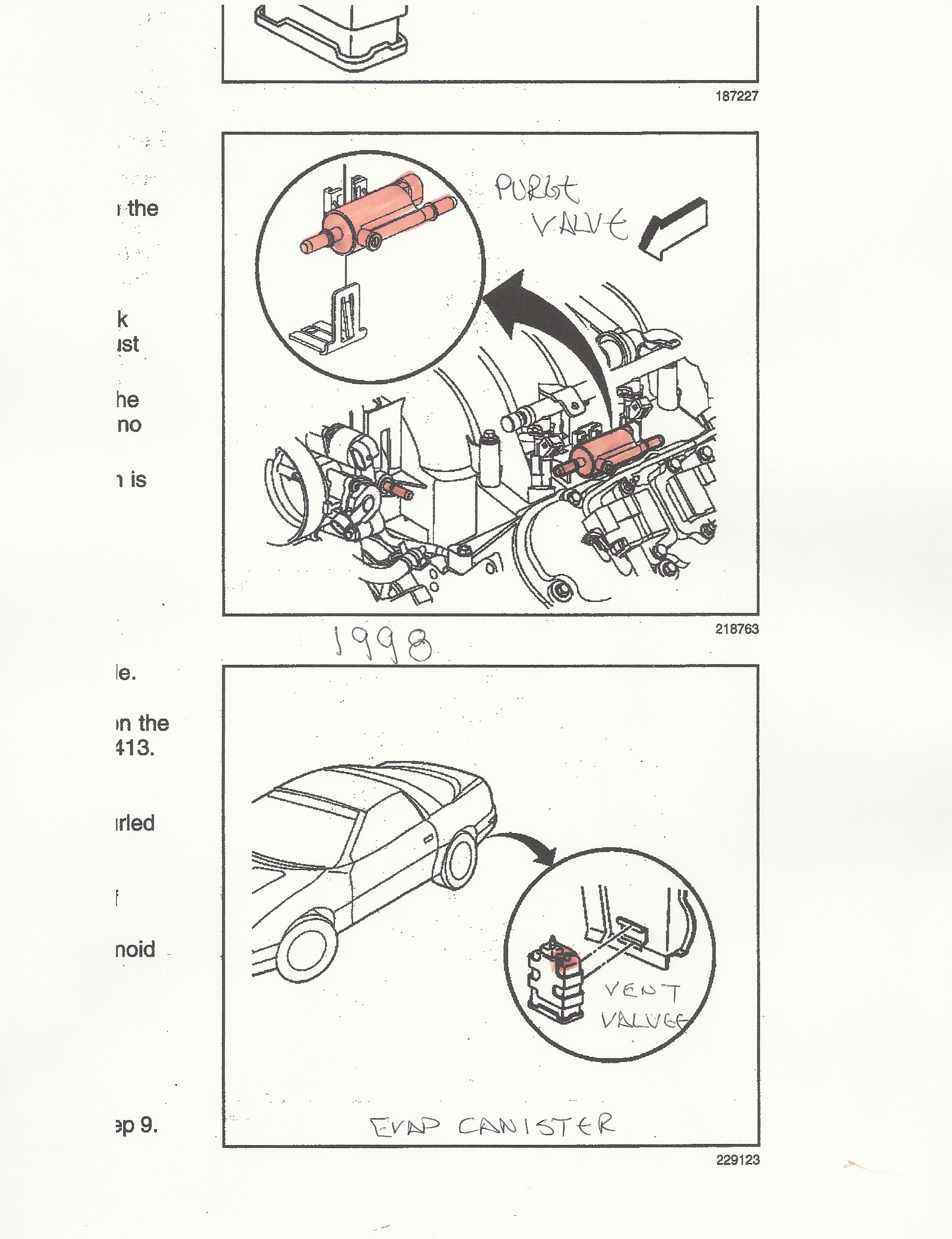

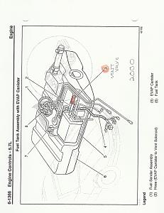

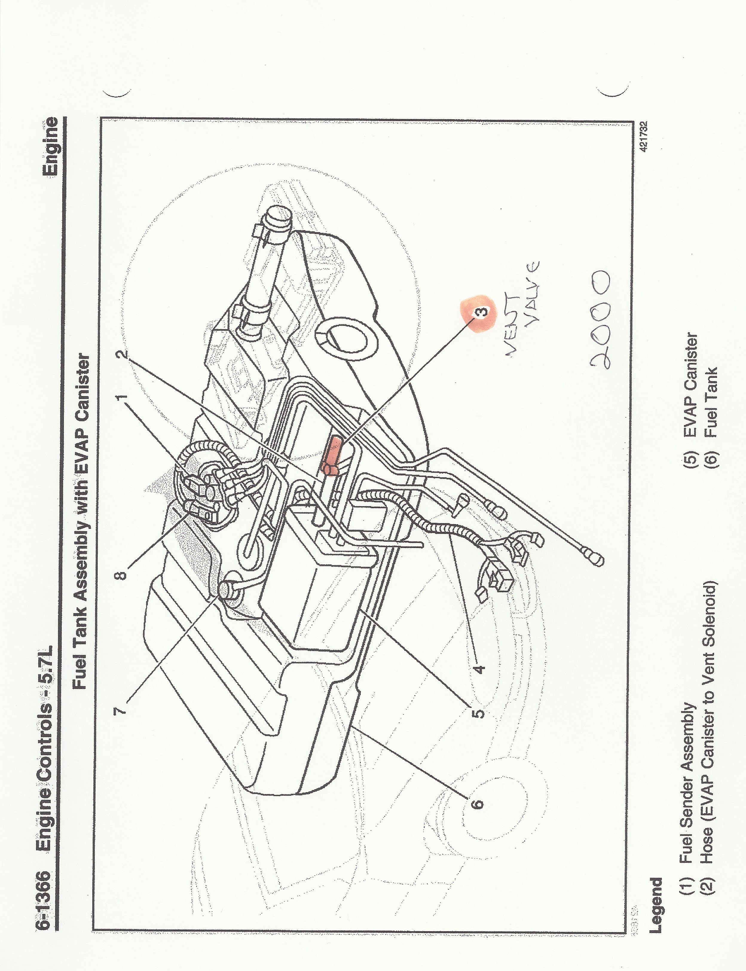

Purge Valve (solenoid) - Both the 1998 and 2000 manuals show the same location, driver side of engine, middle of the intake manifold.
Vent Valve (solenoid) - This valve is part of the charcoal canister. In 1998 the canister was located in the driver side rear fender well. In 2000 it is shown mounted to the fuel tank. I suspect is was moved when the fuel tank was changed from metal to plastic. Don't know which location for the 1999.
Attached Thumbnails HELP with my 99 Camaro Z28 V8 5.7-1998-purge-vent.jpg   HELP with my 99 Camaro Z28 V8 5.7-2000-vent.jpg
